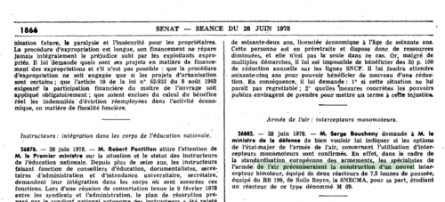

LA SNECMA ETUDIE UN NOUVEAU MOTEUR: LE M 69 La SNECMA étudie un nouveau turboréacteur de 7,5 tonnes de poussée, dénommé M 69, et qui pourrait équiper le futur Intercepteur bimoteur dont les spécialistes de l'Armée de l'Air ...
Air et cosmos march 1978 (715 to 730 )
look ma ! Rafale as early as 1978... and freakkin hell, as a Mirage 3000 ? right between Uncle 2000 and father 4000 lol.
Rapport du Sénat / Sénat parliamentary report - June 28, 1978. Right between the 2000 and 4000 first flights.
With that snipet inside.

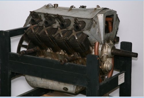

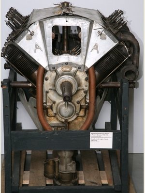

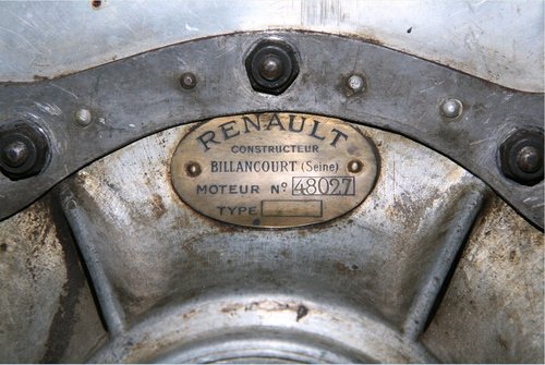

Dear colleagues,
could you help me to identify this Renault V-8 engine with air cooling
Size: 1100 * 800 * 900 mm
Weight: 142 kg
Thank you in advance!
