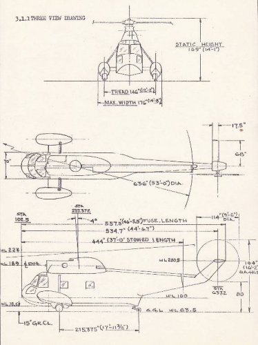

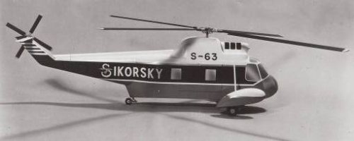

the Sikorsky S-63 was developed from S-62,with a single turbine engine as a utility
helicopter,only one helicopter was built.
http://www.sikorskyarchives.com/S-63%20single%20turbine%20utility%20helivopter.php
