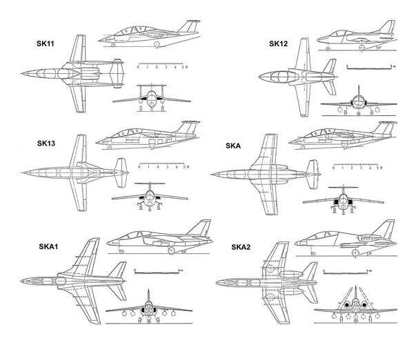

Looking around regarding the name, SKA seems to mean skol-attack, "trainer-attack", which was a prefix Saab used for period aircraft projects intended for both roles. I think SKA here refers to the Saab 38 aircraft project which they were working on at the time, and ASM simply means anti-ship missile. SKA ASM = anti-ship missile for the projected SKA attacker-trainer aicraft.
Image from Facebook.

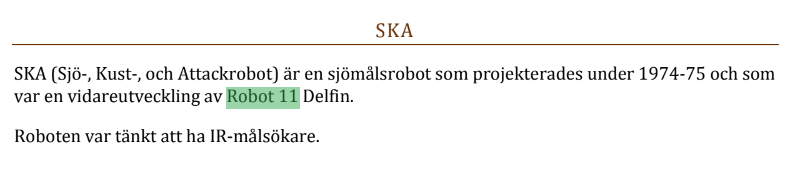

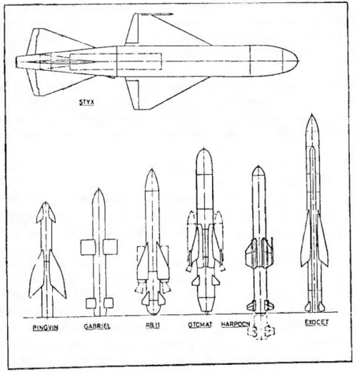

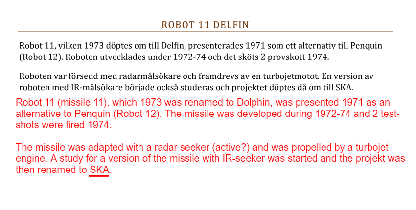

Found more about the rb11 in a different pdf.
Robot 11 is a Swedish robot, so far as a first preliminary project, prepared by SAAB. The starting weight is estimated to be approx. 640 kg, the length is 3.8 m and the warhead weight approx. 125 kg. A solid propellant-rocket engine gives an average speed of M 0.8 (274.4 m/s). The robot can make a course change of about 40 degrees after start. The range is about 35 km. It is designed to also be used in coastal artillery.

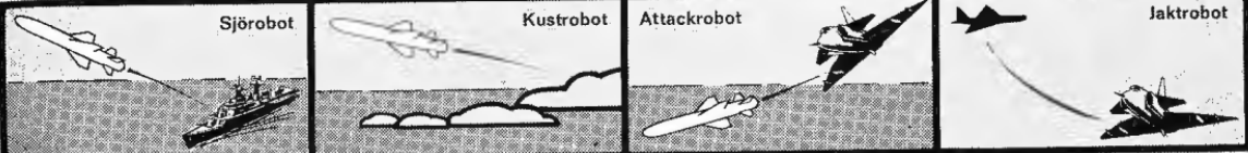

Well here we go, seems i am blind. In the same pdf as mentioned above, SKA stands for "Sjö-, Kust-, and Attackrobot" (Sea, Coastal and Attack missile).
This goes together with the ad above, minus the fourth image depicting it for air-to-air usage.
