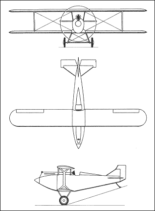

I-1 was a single seat single bay biplane fighter,of wooden construction,built by Grigorovich to compete the Polikarpov design
I-2 was a single seat biplane fighter of 1924,developed as a refined version of I-1,powered by one 400 hp Mikulin M-5 engine,Grigorovich

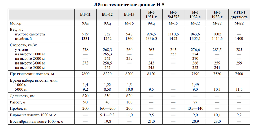

I-5 was a single seat biplane fighter,work had done in jointly with Tupolev and Polikarpov as ANT-12,later it was transferred to Polikarpov to develop as VT-11
I-5 (VT-11,VT-12 & VT-13) was a I single seat biplane fighter,powered by one 480 hp Shvetsov M-22 9-cylinder engine,Polikarpov 1928
I-5 UTI-1 training the cockpit was moved forward and a second seat with control for an understudy was installed behind it. It was converted from a conventional production aircraft into a two-seat training aircraft in 1934. In the series, 20 vehicles were converted for training purposes
I-5 bis was an improved version of I-5. It did not pass state tests, however, many of the improvements proposed in this modification were implemented on serial I-5s without changing the name of the aircraft

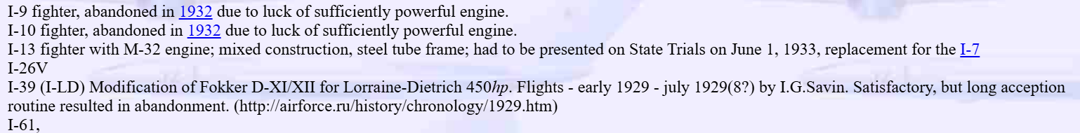

I-9 was a heavy fighter design of 1932,it was powered by either two M-30,M-31,M-32,M-37 or M-38 engines,Grigorovich 1932
I-10 was a high speed fighter of Elektron (magnesium alloy) and powered by M-41 engine,1932
I-11 was a single seat high speed fighter monoplane project,to be powered by the in-line Mikulin M-34 engine of 750mhp. The design was produced during 1932-33, a period for which few records survive. The M-34 was a Soviet designed 12 cylinder inline V water cooled engine that was created to replace the M-17, a licence built version of the BMW VI engine,Polikarpov
I-12 (First use) was a single engined fighter project designed to the I-12 specification issued in July 1930. The specification called for the development of a fighter armed with Kurchevskiy DRP recoilless guns,it had twin boom shape,engines of foreign and Soviet manufacture was considered, including the 575-hp Pratt & Whitney R-1860 Hornet B-series nine-cylinder radial, a supercharged version of the Armstrong Siddeley Jaguar 14-cylinder radial and the Bessonov M-29 14-cylinder radial with a design rating of 750/1,000hp,ANT-18 second use of designation.

I-5 (VT-11,VT-12 & VT-13) was a development of Tupolev ANT-12,as a I single seat biplane fighter,powered by one 480 hp Shvetsov M-22 9-cylinder engine,Polikarpov 1928
From this source.
From this source.
The Polikarpovsky I-5 is not a development of the Tupolev ANT-12. Tupolev is trying to use his connections (lobbying) to select the development of a single-seat I-5 fighter for his office. Hesham do not mislead. This is natural because you have a poor command of the Russian language
From this source.
Of course I didn't mean any mislead,but this Info was from Net,OK,I will edit it.
There was I-2bis also.
