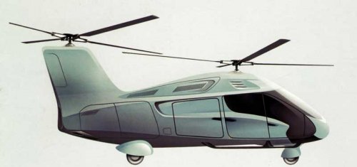

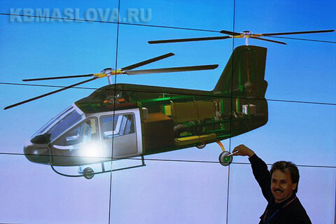

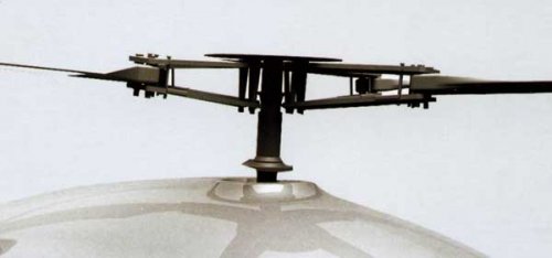

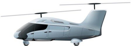

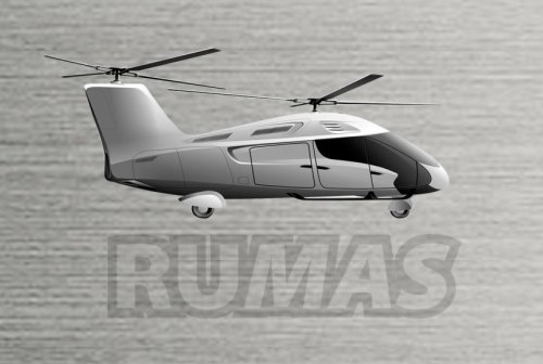

Newbie KB Maslov has shown their RU-MAS 240 chopper teaser. Istead of reposting more images, here's the link to original site http://kbmaslova.ru/A.html

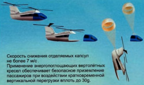

While going on the technical side, Ru-MAS 240 should have some interesting features, like rotors pitch control rods hidden inside hollow drive shaft, jetissoned crew cabin for rescue, etc. Seemingly, we see engineering outsourcing case, as they hire aviation engineers.
While I hardly believe this project (or any other od Maslov's choppers) ever will be completed under current economic conditions, but anyway, this one is interesting.

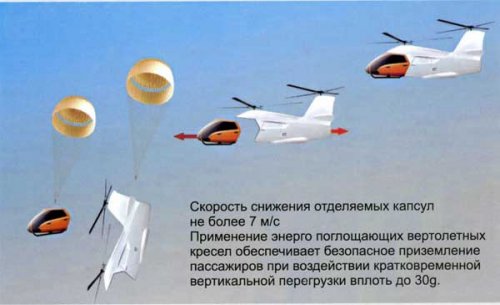

That seems silly. I think it would be a lot easier and a lot lighter to leave the cabin in place, and just blow off the rotors and bring the whole thing down under chutes. I'm not sure how often that would be a better idea than autorotation, though.
They may be thinking of such scenarios as catastrophic engine fires. By the way, I wonder if the system used for the cabin and fuselage is a licensed application of the Ballistic Recovery System? It would seem consistent with the Maslov Bureau's apparent business model for this particular programme.
By the way - it may seem silly to eject an entire crew compartment, but it has a lot of merit if going down in harsh environments where rescue can be delayed (e.g. cold, isolated areas). Keeping wounded crew close to survival gear can be essential in giving them long enough to be retreived.
I agree that chuting the entire airframe would be simpler. But I don't think autorotation is automatically a better idea. It doesn't help if there are rotor or transmission problems, and many real life autorotations get screwed up in the last few feet. To paraphrase the old joke about twin engines, the purpose of autorotative flight is to deliver you to the crash site.
I do get very nervous when people talk about blowing the rotors off. Timing would be extremely critical with a tandem rotor, a slight delay in blowing one rotor could place the airframe in an unwanted attitude. From that point of view, it might be easier to separate one cabin than to separate two rotors.
And speaking of two rotors, can anyone offer a reason for the different diameters of the two rotors? One of the classic advantages of the tandem rotor is identical hubs, blades and controls front and rear. Simplifies productions, spares, servicing, etc.

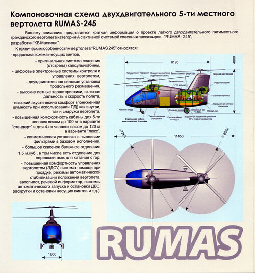

The RU-Mas 245 project. I can't see what really distinguished it from the earlier RU-Mas 240. Dimensions maybe?

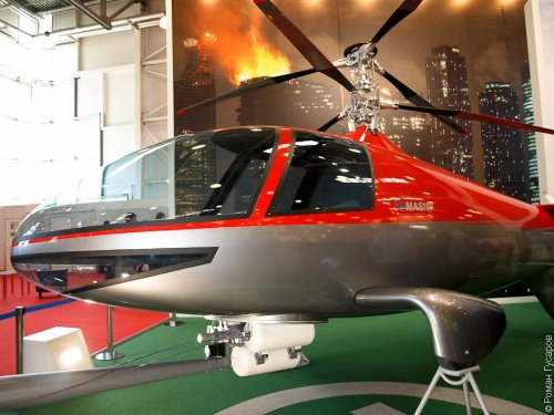

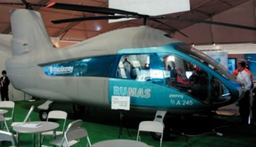

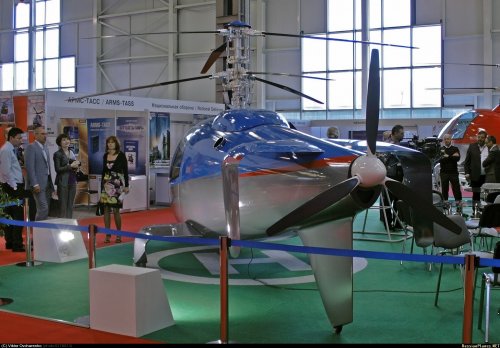

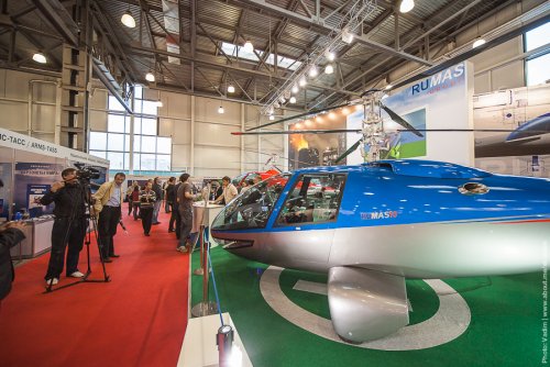

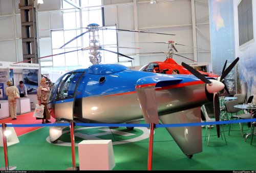

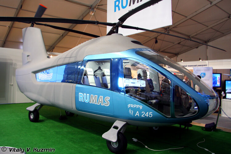

Now designated as the RUMAS A245, at the MAKS-2009 airshow:

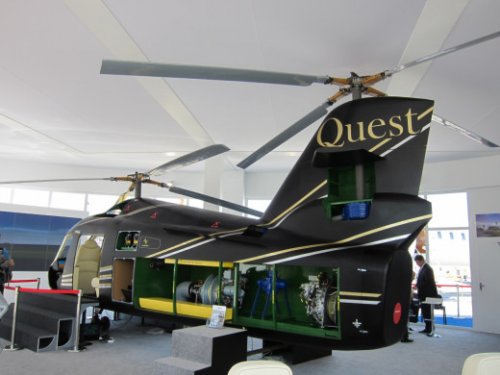

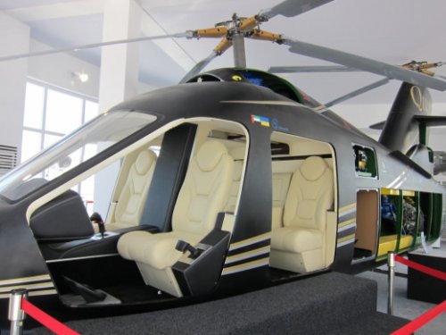

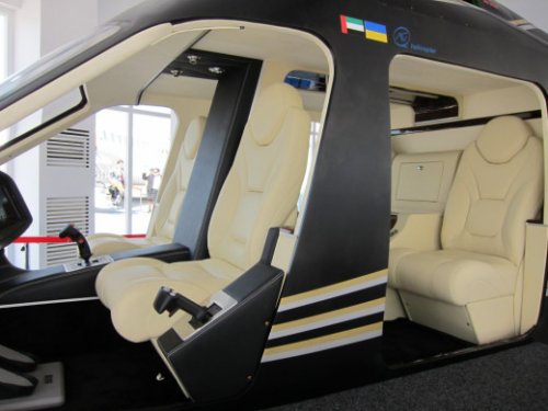

Mockup of UAEi-based Quest Helicopters AVQ based on RUMAS A245 shown at Dubai Air Show 2011.
http://missiles2go.ru/2012/02/06/%D0%B0%D1%80%D0%B0%D0%B1%D0%BE%D1%83%D0%BA%D1%80%D0%B0%D0%B8%D0%BD%D1%81%D0%BA%D0%B8%D0%B9-%D0%B2%D0%B5%D1%80%D1%82%D0%BE%D0%BB%D0%B5%D1%82-%D0%B4%D0%BB%D1%8F-%D0%BE%D0%B0%D1%8D/

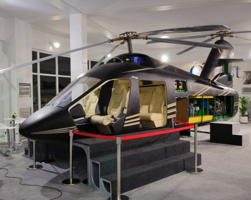

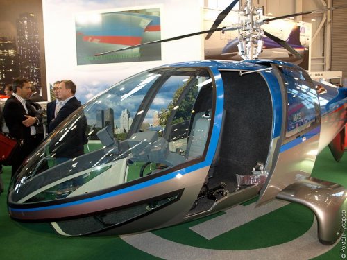

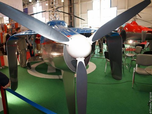

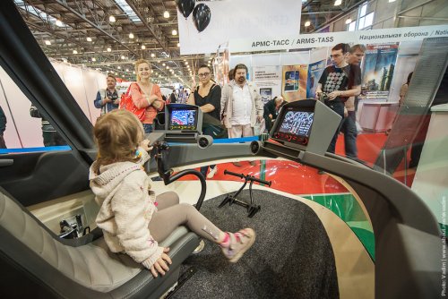

Mockup of RUMAS 10 on display at HeliRussia 2012.
http://www.aex.ru/docs/3/2012/5/21/1572/print/

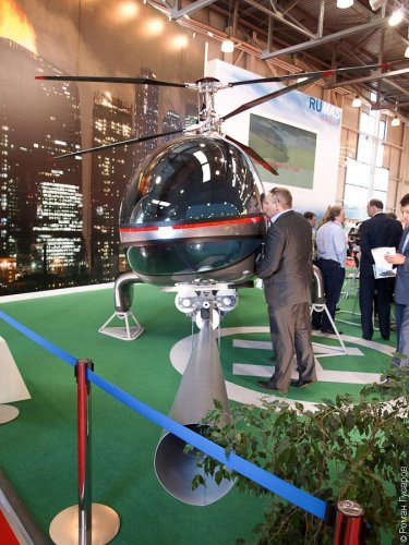

Mockup of RUMAS 10F on display at HeliRussia 2012.
Mockup of RUMAS 10 at HeliRussia 2012.

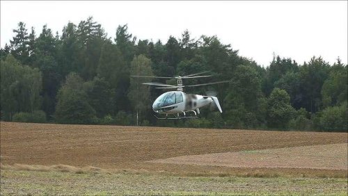

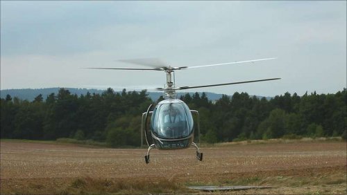

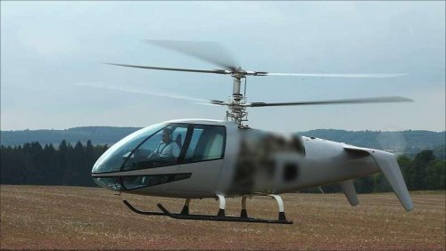

Igor Maslov has posted pics of first RUMAS 10 hover at Paralay's forum. Congratulations to RUMAS team that went through harsh seas.
Congrats indeed! I have to be honest that I would not have bet on their getting to this stage.
