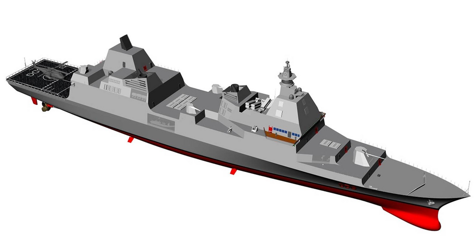

That's not quite the most recent concept, that one's a little older than the many-faced array being shown off above. This one cuts down on some of the smaller panels, but the eight main ones looks the same.
Jeez that is not attractive.
Always seems strange to see the radar antennas tower over the ESM kit.
Logically shouldn’t the ESM antenna(s) be positioned at the top of the radar mast to allow for maximum passive surveillance? While the rest of the ship and the actively emitting radars are still hull down under the radar horizon. (Eg. Italian DDX, Australian Hunter, French FDI antenna arrangements etc)
Yes, ESM should be as high as possible. It's why US subs have the ESM antennas built into the periscopes.
Its the Type-83 so will never have US radar. But any S-band arrays will need to be mounted lower. BAE is developing a next gen Sampson for the Type-83.

The pagoda design is slightly better, but BAE raised the flight deck from T26 for some reason (I notice no boat bays?) in order to give the same flush deck as T45. It's also very fat in order to carry the big radar on a 160m hull:

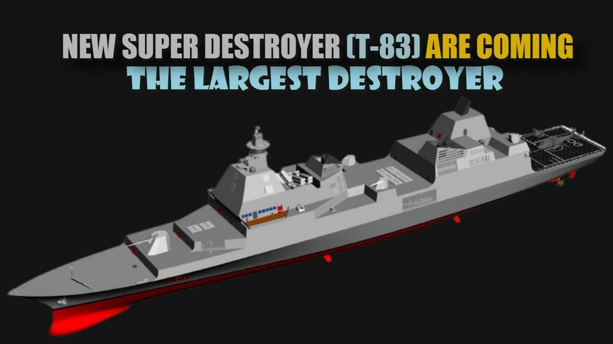

I would just say that the central warship in that render is a concept from neither BAE nor Babcock, but a placeholder for the RN for various PR and other such events.
That's the BAE Future Air Warfare Command Ship concept, isn't it?
The RN's own placeholder from the NDP is this one:
I'm suspicious of that image on the whole as well. I can't really find it anywhere else, and I have feeling it might be a Navy Lookout AI-special rather than an official release.

1779964313647.png Sorry, I was talking about the concept in this image here. My mistake.
The thing that I think is interesting is that all available detailed concepts seem to lack a hull-mounted sonar.
do they have 2 towed arrays? one shallow and one VDS? If so you don't absolutely NEED a hull-mounted sonar. Especially if the planned mission area is deep water.
IMO the correct sonar rig is shallow towed array and VDS at the stern for deep water, and a hull sonar at the bow that is optimized for water too shallow to run the towed arrays. But that does cost. If you do the fitted for but not with game *spits*, the place where the bow sonar would be still gives you that nice big bulbous bow for improved wake control.
No no you're right, that's the RN concept not the BAE one. It has the same 40mm arrangement. It's missing the rotating masthead array which was enough to make me think it had the chonky BAE mast.
