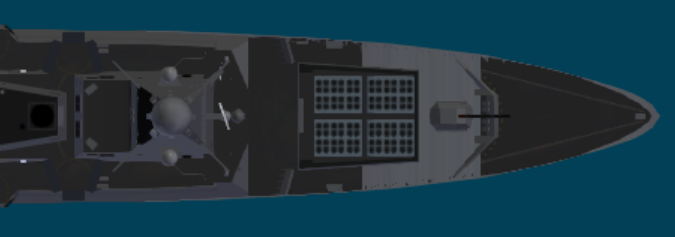

FWIW here is a little more accurate (very crude, never mind the slight offset of the middle row) comparison of the missile space with Mk.41:
They appear to be very slightly larger than the Aster cells and 72 of them go there like a charm in three rows, and that's not including the forward space shared with gun magazine.

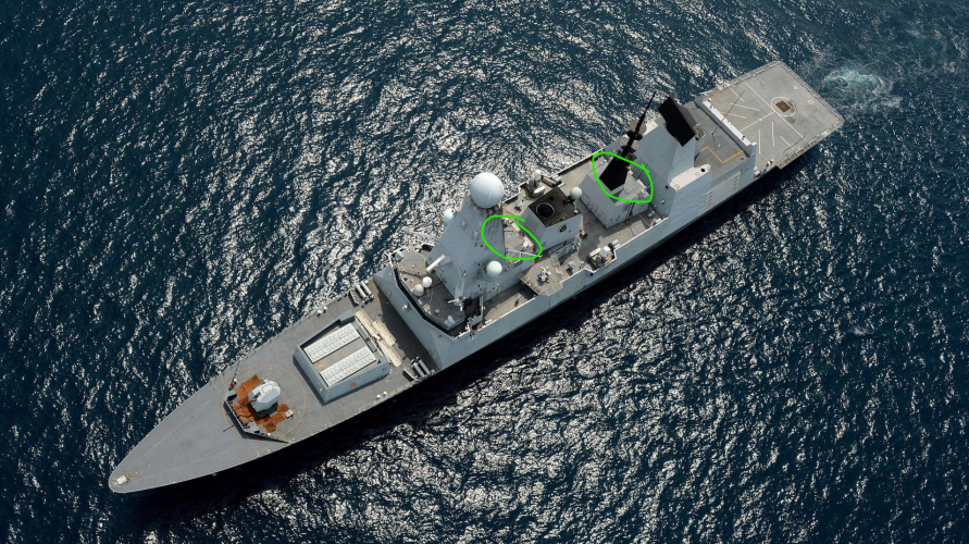

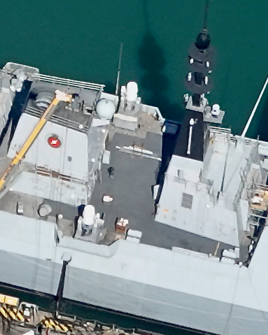

Was it prudent to insert the launchers between the communications mast and the aft radar (which is kinda implied in the description), or a real implementation could have had the mast and the launcher exchanging places? It's an official BAe proposal, so they must have thought about this one way or another.
