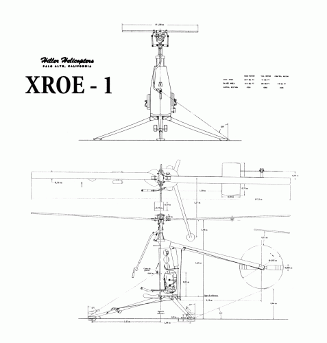

Original Hiller two-view arrangement from the same source:

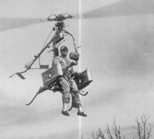

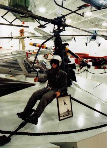

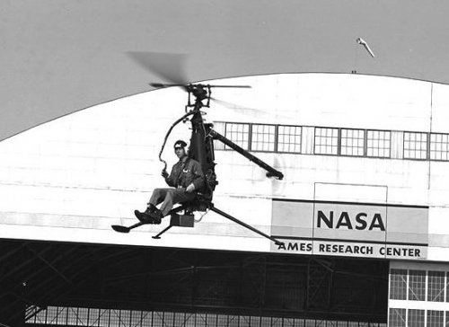

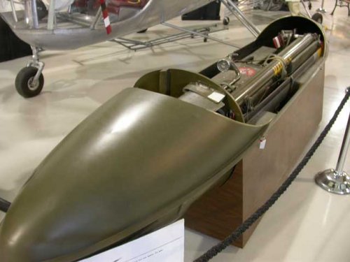

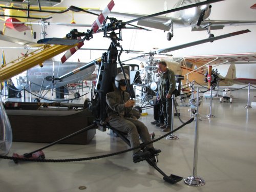

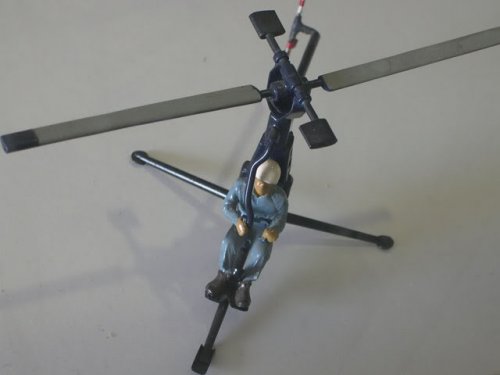

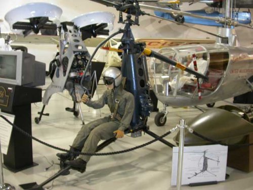

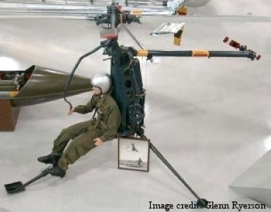

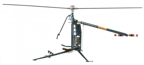

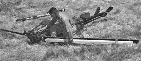

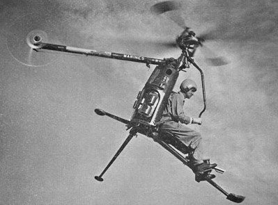

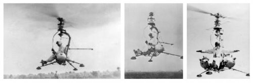

A few pics collected from various sources (including a period desktop model):

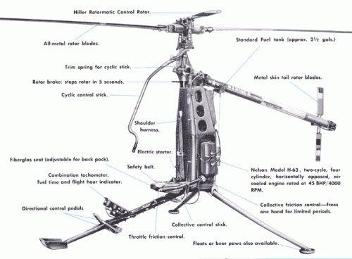

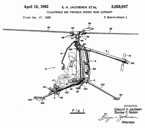

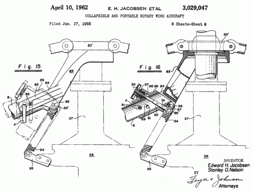

More plans of the Hiller Rotorcycle from various sources:
1) patent
2) patent
3) Hiller brochure
4) Standard Aircraft Characteristics NAVAER 1335B (Rev. 1-55)

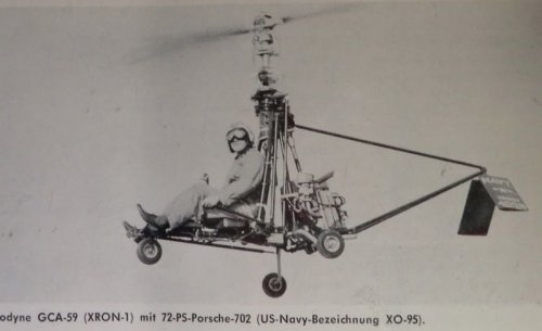

Another photo of the Gyrodyne CGA-59 XRON-1
(from "der Flieger" January 1963)
Caption is erroneous here. The GCA-59 was the second YRON-1 preseries batch with Porsche YO-95-2 engine (one of these being later converted with a Solar T62 engine).
