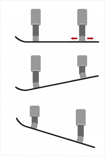

Perhaps a combination with skids would be possible, too, if one of the attachement points
of each skid would be made slidable ? Those "robotic legs" principally don't do anything else,
than very long stroke hydraulic pistons, I think.
