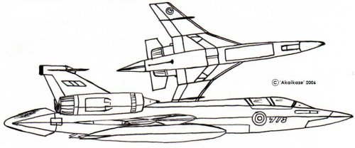

Here's a quick design sketch for a 'What-If' aircraft that's been running though my head. Basically, it's a design for a replacement for the Buccaneer strike aircraft, flying sometime in the mid-60's. Just thought I'd share it...

Interesting concept
I see that you have kept some of the design traits that the Buccaneer became known for – i.e. the split tail/airbrakes arrangement and most importantly an internal weapons bay!
Is the weapons bay of your design a rotary (Martin) arrangement like that of the Buccaneer?
Of interest what made you pick a pod engine arrangement?
The only thing that looks dubious to me is the wing design – as operating from a carrier!
Are you planning to do a model of this?
If so good luck, and keep us up to date
Regards
Pioneer
Nice concept. But I also think that the different air intakes or different engines placement should be used. Maybe then it will look much futuristic, who knows...
Mid-60's? You've features there that generally didn't appear, or were considered generally needed, until a couple generations of combat aircraft later when Low Observables (LO) became more important. I'll grant you that it's generally a good LO design, but that doesn't fit with the approaches taken at the time.
