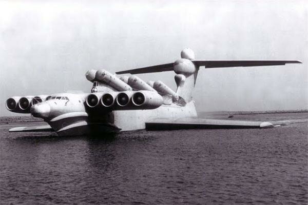

Most of the images of real WIGs that I've seen show them to have enormous tailplanes. In the case of the Lun and Caspian Sea Monster, those wide rows of engines would probably add to pitch stability as virtual canards.
