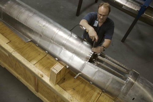

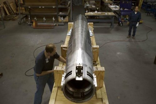

Klune. The people making the fuselage.
http://www.klune.com/casestudies/rattlrs

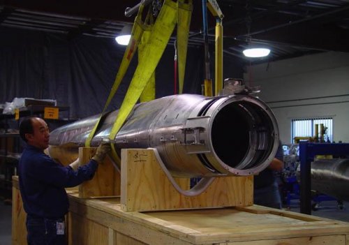

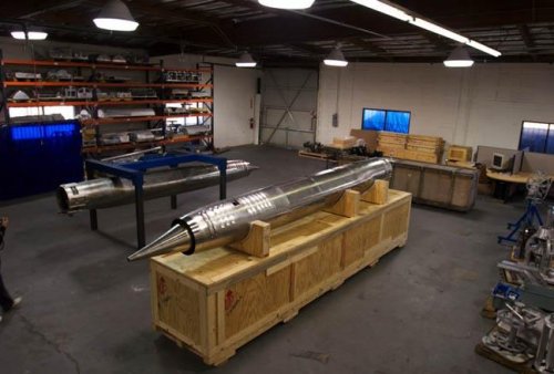

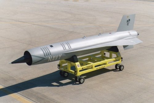

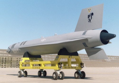

RATTLRS full-scale mockup at KNTD in the Fall of 2006 for display at a "Friends and Family Day". Images (c) me. Virtually nothing about the program has surfaced since. To me, this would leave two alternatives:
1) The program ran out of money and died a painful death in obscurity, or
2) The program went sub rosa and then succeeded or failed in obscurity.

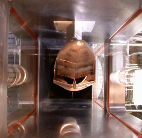

RATTLRS Air Vehicle Baseline (AVBL) Forebody Inlet Screening Test.
A high Mach number inlet design for the RATTLRS / AVBL concept was tested at the GRC 1’x 1’ supersonic wind tunnel. The model was tested at Mach numbers 2.5, 3.0, 3.5 and 4.0. The inlet flow was captured and measured for yaw angles ranging from -2 to +2 degrees, and for pitch angles ranging from -2 to +8 degrees. A new remotely variable
strut was developed for this test and contributes to the tunnel capabilities. This test data will be compared to analytical (CFD)
predictions.
Also of note, the inlet model hardware was created using an
innovative design and fabrication technique. Using a two step
process, the model’s form was generated in a rapid prototype
laser sintering machine. Then, in a high temperature oven, a
bronze infiltration technique was used to create the final metallic
SLS form. The fabrication was awarded the GRC craftsmanship
award and was featured at this year’s Oshkosh show. The data
will serve as the validation reference for evaluating CFD
analyses of integrated inlet / forebodies with 3D flow spillage.
Also, this data will help to advance an inlet / vehicle concept
which is a candidate for flight demonstration or small turbinebased
hypersonic vehicles. (contributed by Mike Henry, QSSGroup, Inc.)
"RATTLRS forebody model installed in the 1x1 SWT."
WTF is that AVBL I never heard about and why it have nothing common with RATTLRS as we knew it (before it was no more)
