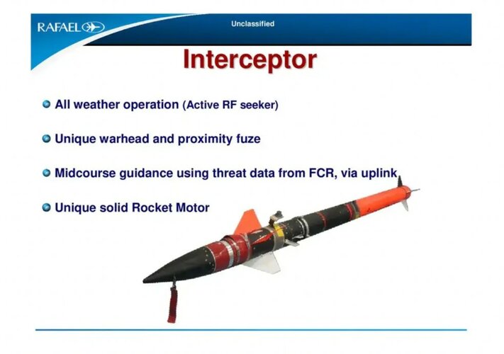

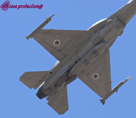

I also know the IAF at least tested an air launched Stunner missile.
What I'm wondering about is how the SkySting achieved its characteristics, why was the Stunner AAM seemingly abandoned, and generally about AAMs today.
Stunner is a hit to kill missile. On SkySting's page we hear nothing about the kill mechanism. The word "warhead" is not mentioned, nor "kinetic" or "hit to kill".

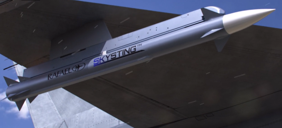

In the image below I don't see any strakes that could increase its lift. Instead it has 3 sets of 4 fins. Minor departure from the Derby's long tail fins into a pair of smaller ones.
I guess their drag could be reduced via clever flight path. So the main range improvement must come from the different motor. But it still doesn't sit well with the present vector to remove control surfaces.

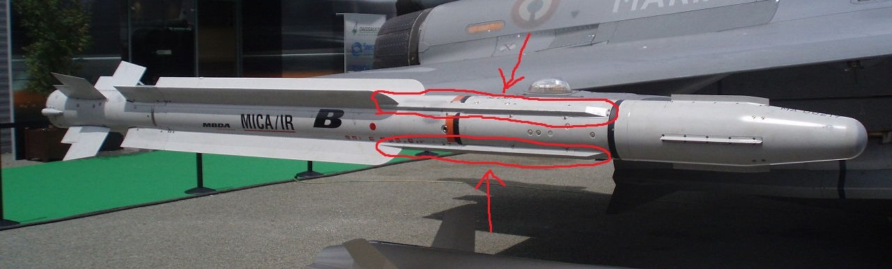

- What could the SkySting's underbody protrusion be?
- It runs nearly along the entire body but it doesn't seem to have an opening.
- Could it indicate motor length?
