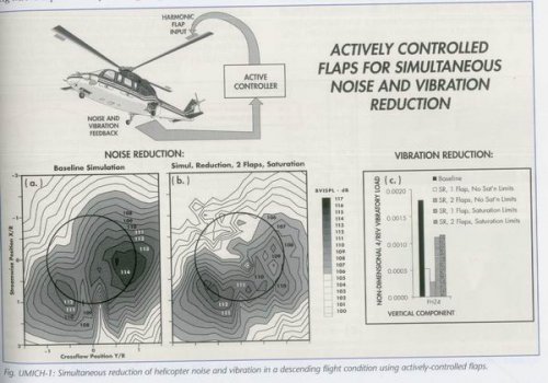

I had a look again at the back issues of vertiflite and found an article in the winter'04
issue about the work of several companies in the field of vibration and noise reduction.
Here, generally accelerometers are used for measurement of vibrations and the output
signal is used to counter balance vibrations by influencing the rotor. Here several different
ways are explained, on of them is shown in hte diagram below, using flaps at the rotor
blades. Another system is the active camber rotor blade airfoil concept.
And the Sikorsky S-92 is mentioned, as the first production delivery utilizing an AVC
(active vibration control) system. The main aim is to decrease vibration loads and so allow
for a lighter structure and enhance crew comfort, but decreasing noise level probably
is achieved as well.

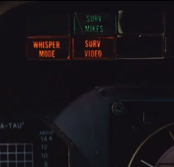

Anyone remembering the 1997 movie Conspiracy Theory (Julia Roberts, Mel Gibson)? They had an special method for noise reduction written into the script, a kind of technospiracy in itself. When the men in black in their helo descend, cut into the hightech interior of the helo, where on the overhead dashboard a switch is manually activated: „whisper mode“. Immediately the overall noise the helicopter generates is reduced to a … yes … whisper.
I talked to people who believed it was real tech.
main-qimg-ecc93db88515c11546f52d9667df7364-lq
Blue thunder had it back in the 80's
Yesss, even better … that was the image I remembered, and I put it in the 1997 movie, where they do what I described above, but without the dashboard actually having written „whisper mode“ upon it. However, in the same scene intercut is Gibson, driving a cab and ranting on about the black men in their silent helicopters, using … and he says it: „whisper mode“. Chances are it is a reference to Blue Thunder.
