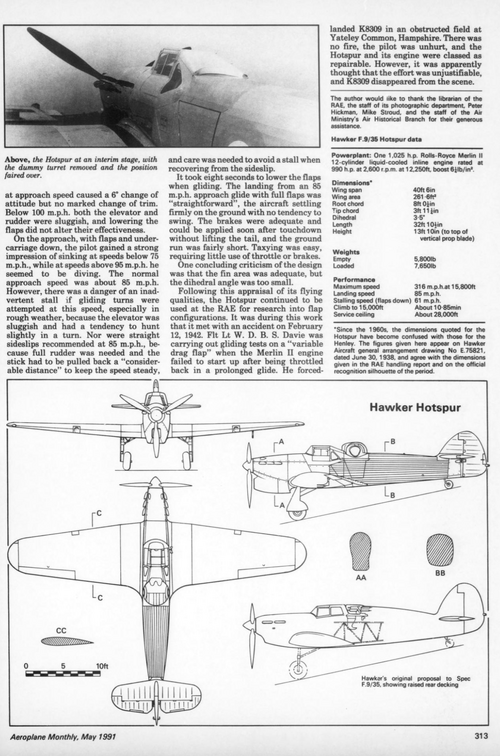

From Aeroplane monthly 1991.
Thank you :)
Some other questions pop up now - speed of under 300 mph were recorded during the 'brief performance trials', when it caried the mock-up turret and ballast, that was 20 mph better than Defiant?? The article notes 316 mph, however - as good as the more slender and turret-less Hurricane.
Is there a convenient was of contacting Tony Buttler, perhaps he can shed some lights on this topic?
Thank you :)

I was comparing the speed figures of the two. Data sheet for Hurricane I, 316 mph.
Hotspur did have a bit a wider fuselage (for greater drag), however the radiator was probably better than what Hurricane had.
