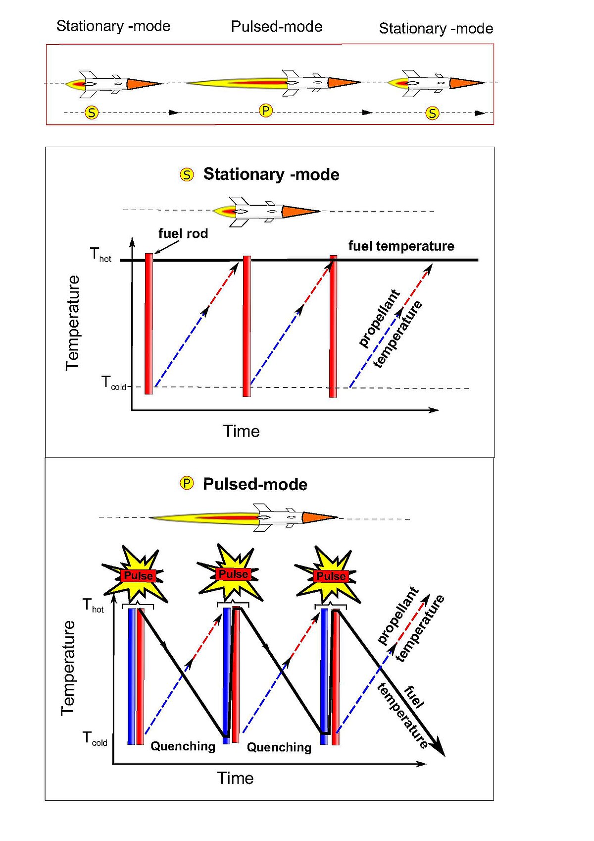

- clearly something is wrong between the 5000 megwatt reactor and the high energy hydrogen fuel... you guess, is it the energy "vector" between the two
- fission fragments are that vector, works by passing their energy as heat to the hydrogen
- "heat" sucks because thermodynamics sucks.
As would say Mark Watney "that fucking entropy !"
- now if you used neutron kinetic energy from a pulsing reactor high neutron flux...
