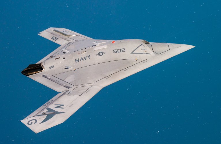

The shape they use for their examples is X-47B, which may work but is too small for the needed load for the strike and maybe EMW missions, IMO.
I think that the X-47B size would be acceptable for Integrated Air and Missile Defense, IAMD, which I am reading as "BARCAP plus" and "high endurance spear carrier." But it's only got 5200lbs of payload. Should be able to carry at least 4x if not 6x AMRAAM-sized missiles. A UCAV big enough for the other missions could likely carry as many as 18x AMRAAM-sized weapons.
