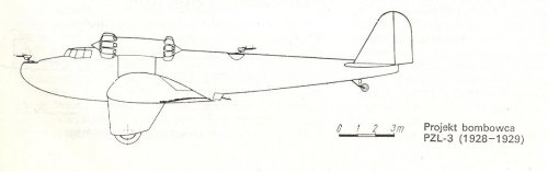

3. Bomber PZL-3 of 1928 only project, French firm Henri Potez built the copy
of PZL-3 under designation Potez 41 B4N ;

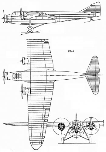

I am sorry but it isn't correct.

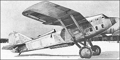

The PZL-4 was not only a project, but a real prototype registered SP-AGY. Its first flight was made at January 8, 1932, by Boleslaw Orlinski. PZL-4 was trimotor full-metal passenger aircraft for 2 crew members and 10 passengers, with three 240-hp Wright Whirlwind J-5a engines. It surely wasn't a great success: the aircraft was overweighted (empty weight 4081 kg instead of projected 3350 kg), and its performance was notable worse than of Fokker F-VIIb/3m with the same engines. Therefore, PLL "LOT" airline wasn't interested in PZL-4, and no more aircraft of this type were built. The prototype was scrapped in 1937.
Here is some info in English:
http://en.wikipedia.org/wiki/PZL.4
...in Polish:
http://pl.wikipedia.org/wiki/PZL.4
http://www.powiat.mielec.pl/poser/samoloty/pzl/pzl04.htm
...and in Russian:
http://www.airwar.ru/enc/cw1/pzl4.html

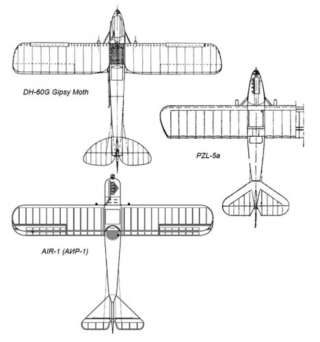

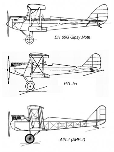

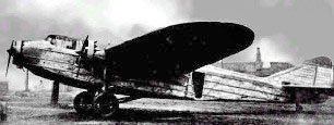

Also PZL-5 wasn't really a copy of DH Moth, but only a similar biplane with the same Gipsy engine. They were notably different in shape, and PZL-5 was slightly smaller. Here are some comparisons (Moth, PZL-5, and Yakovlev AIR-1).

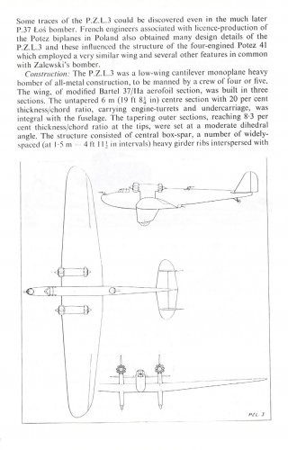

And it's interesting, how much the Potez 41 BN5 (not B4N) was inspired by PZL-3 project, and whetwer the Potez engineers knew about it at all. At http://www.airwar.ru/enc/bww1/potez41.html it is written that Potez 41 was a derivative of unbuilt 18-seat long-range passenger flying boat project. It can explain the configuration of engines - for flying boats it wasn't any exotic.
As for me, PZL-3 project from 1928 looks more advanced than Potez 41 from 1934.
Boogey, you mentioned PZL P.2, P.9, P.10 and P.28. I don't know anything about them. Have you any details?
