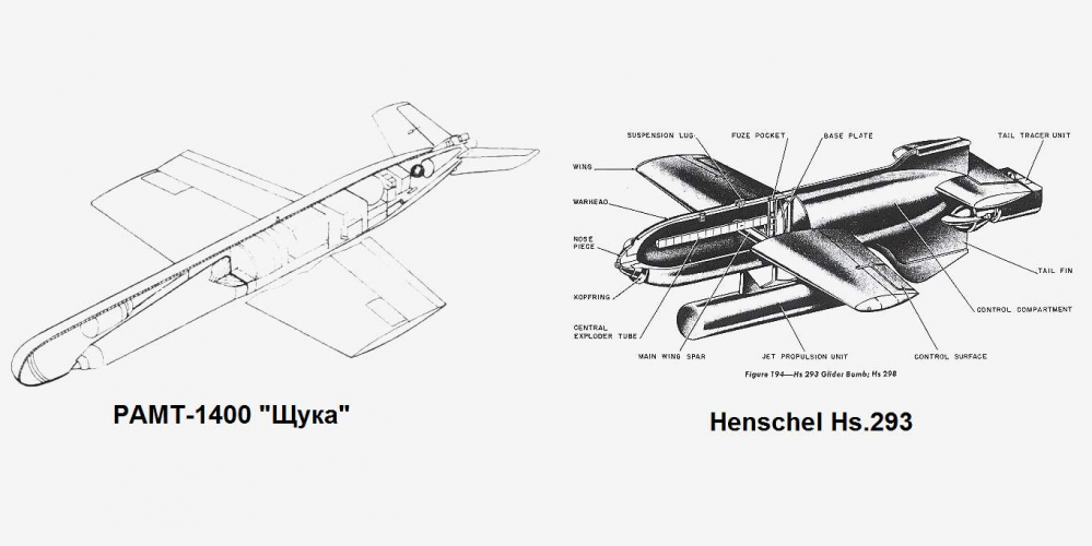

The KsSH early development history is quite a bit unclear. Officially, the missile was initially developed as air-launched missile, RAMT-1400 "Shyuka", based on German Hs.293 project. Personally, I always considered this story highly dubious - the RAMT-1400 and Hs.293 have literally zero in common:

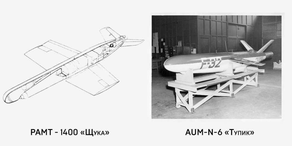

On the other hand - and this is quite interesting - RAMT-1400 "Shyuka" looks very similar to AUM-N-6 "Puffin" missile. Essentially the only major difference is the use of liquid rocket motor on RAMT-1400 (the "Puffin" was fitted with pulsejet). But - in original plans for AUM-N-6 "Puffin", the missile was supposed to carry a liquid rocket motor!
So my personal opinion is, that origins of "Shyuka" missile actually are American (spy-delivered), and not German. Not very important, but very interesting)

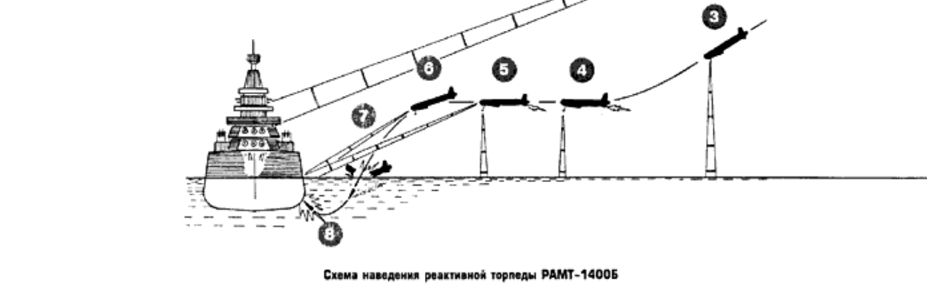

* The missile was turbojet-powered, subsonic, with a max range about 100 km, and max speed of 1000 km/h (0.9 Mach). It followed about 60 meters cruising altitude, and made terminal pop-up maneuver near the target (both to confuse AA fire, and to set the correct dynamic for detachable warhead attack);
* The control system was of "bang-bang" type, i.e. V-shaped rudders were moved from "off" to "on" position & back only. The proportional guidance was achieved by rudder deflection time. As a result, the missile constantly zig-zagged along its flight path (which complicated the terminal approach, but also made missile pretty hard target for AA guns);
* The missile was equipped with active radar seeker of range-and-azimuth-only, horizontal-sweep sector scan. It have scan arc about 150 degrees wide and max detection range about 25 km. There were background noise filter (which automatically reduced clutter from ocean surface), and target signal filter (which set the minimal return signal that missile should lock on). The seeker did not have any specific anti-jamming measure, besides background noise filter. It was generally assumed that the short terminal flight time of the missile simply would not left the enemy enough time to implement sophisticated ECM's (which in 1950s were mostly manually set);
(due to limited anti-clutter ability, the missile could not be used in sea state above 4 by WMO Sea State Scale. If the waves were more than 2 meters high, the seeker would not be able to discriminate them)
* The midcourse guidance was simple bearing-following autopilot and seeker activation timer. Since the autopilot was inherited from air-launched missile - which was supposed to be launched directly at the direction of the target! - the autopilot have no capability of any pre-set bearing changes. So the missile needed to be launched directly at the direction of the target (which required trainable launcher) with distance to the target (i.e. flight time) known to correctly set the seeker activation timer;
(the notion that missile have some kind of midcourse command guidance is a common mistake, likely caused by RAMT-1400 "Shyuka" testing - early models have command guidance, because seeker was not ready yet)

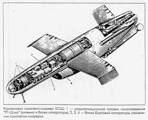

* The missile was equipped with detachable "diving" warhead (about 600 kg, of which half was explosive filler), cone-shaped, placed below the missile body. Such warhead was chosen as more efficient against heavy-armored battleships with thick anti-torpedo defenses. The idea was, that the missile would dive into water about 50 meters from enemy ship hull, the warhead would detach at the entry, move underwater at curved upward trajectory, and hit the enemy battleship right into its bottom:
(the nuclear warhead was considered at some point but eventually rejected due to size restrictions)
(that's scheme for original RAMT-1400 missile, but you got the picture)

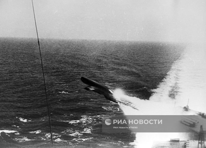

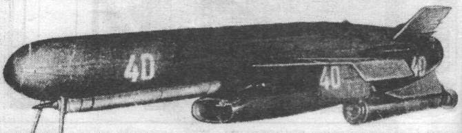

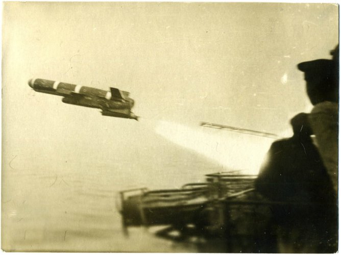

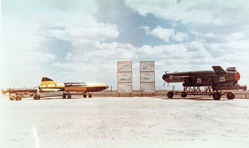

AFAIK this has been one of the least-displayed of Soviet/Russian cruise missiles. Here are a few of the best photos/diagrams I have seen:
Very rarely shown, indeed. Most likely due to limited service and the fact that it became outdated quickly. Ironically, Project 57bis destroyers represented "modern missile destroyer" in Soviet naval-themed literature up to 1980s)

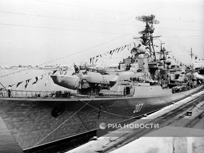

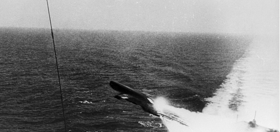

Heres one of the few color pics of the destroyer,taken around 1964-66.

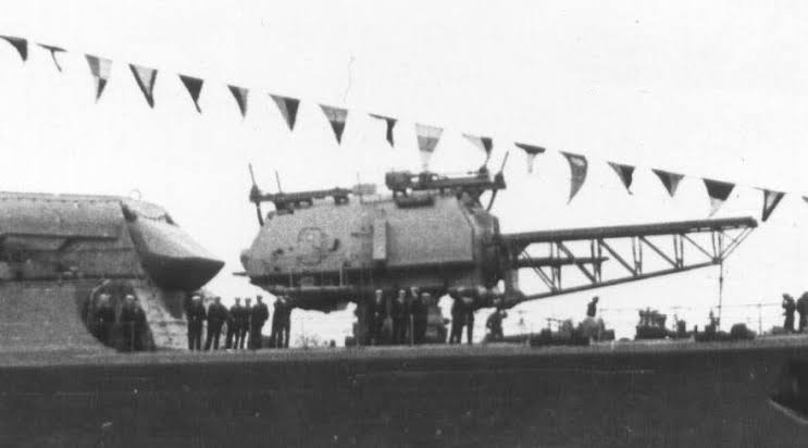

Heres an unusual one with a cover over the launch rail.
