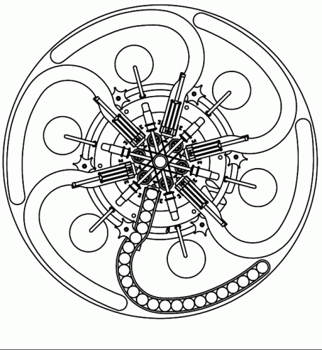

they really went to Coca-cola to find a way to Store and deliver tausend Atombombs to injector ?
Yes. The early Orion pulse unit storage and track system was rather clumsy. The final design was really quite elegant. It wasn't exactly a straight scaleup of a Coke machione, but they did learn useful things from the Coke people.

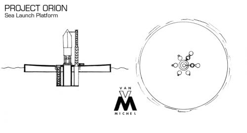

so here my version of Orion Sea Launch Platfrom
as model I used USAF Orion Space Ship 10 meter ø
there 6 Service towers and supply towers (raised above like Titan I Silo system)
the Blast Pit is close at on end ! idea behind this:
the walls are strong enough support the blast.
before liftoff few thousand-gallon-per-second seawater runs wall down.
the shockwave of first detonation focus downwards reflects at bottom
and give additional trust to pusherplate (including the water vapor.)
so can they use a smaller nuke for the first blast.
or is this a "Flash in Pan" Idea again ?
Based on experience with the subscale flight models and ideas regarding silo-launched nuclear retaliatory Orions, what *might* have been done with a floating ocean-based platform is that the orion would be kept within a silo and launched like a sea launched ballisting missile. Basically, shot into the air via compressed gas (generated by tanks of pressurized nitrogen, say, or vaporized liquid nitrogen, or possibly something like gunpowder), and the first nuke is fired only after forward motion is attained and the silo is cleared.
One discovery of the flight models was that Orion may not work very well at zero velocity within an atmosphere.
It might have looked somethign like this:
Since the pusher plate was of slightly larger diameter than the rest of the vehicle, and you wouldn't want to scrape the plate or the vehicle along the walls of the silo, the Orion could well have had a sacrificial sabot somewhat like the MX. Big chunks of foam, I'd imagine. They'd get blasted to flinders by the nuke, but who cares?
