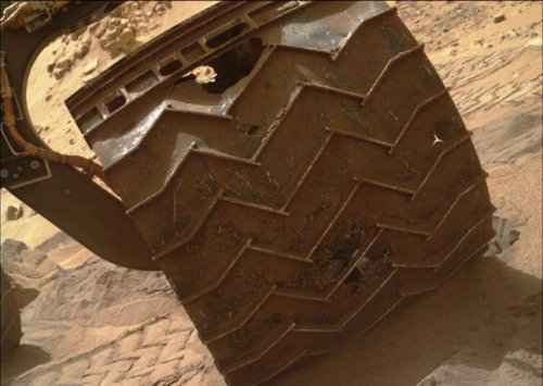

They were only about 5% through the planned driving distance and they'd already worn holes in the wheels. Metal wheels.

That wheel looks like its been used for years. What is causing so much wear and tear on the metal? oxidation? Temperature?

The thing weighs as much as a small car, the wheels are made of thin lightweight metal, and it's driving over abrasive, hard, sharp rock. I'm not sure what else they thought would happen.

Either way, the wheels are still enduring and the rover has since completed it's mission minimum expected duration (which passed 4 months ago) and now it's more or less operating in overtime.

What they thought would happen was that the terrain would be more like the other Mars rovers encountered, where traction in sand was more important than dealing with sharp rocks.
It turns out that there were a lot of factors that went into the wheel design that was adopted and it seems to be working well enough.
http://www.planetary.org/blogs/emily-lakdawalla/2014/08190630-curiosity-wheel-damage.html

How many Mars rovers have you designed?
It's a fun game for people to point to the wheels and say--like you did--"they must be a bunch of idiots to have not known that would happen." Keep in mind that these are the same idiots who successfully landed the largest ever payload on Mars, one which is still working.
Why did that happen? Because the extensive experience they had with their other rovers never showed that kind of problem. All their soil data indicated much softer terrain. It just happens that Curiosity landed in an area with areas of terrain that include jagged ridges on top of rocks, which they had not seen before and they could not predict. They have since learned how to deal with that in their operations.
If you are really concerned about this, I can provide you with the mailing address where you can apply for a job at JPL and you can go work there and convince them to use your wheel designs instead.

MSL's wheels did not fail. Cracks and holes were expected and designed for, and the wheels were designed to be still functional even when a large amount of their surface is removed.
The only thing that went wrong is the rate at which damage appeared was higher than anticipated. Despite this, they were able to finish the primary mission and they're still going several months into the extended mission.
Was there a problem? Yes. Did the mission fail? No. Did the mission fail at 5%? Hell no.
The Planetary Society blog post referred to by TomS is well worth reading.
There were several factors that drove them to design the wheels to be as lightweight as possible. The large size of the wheels means that very slight design changes add a substantial amount of mass. Increasing wheel thickness by one millimeter would add 10 kilograms to the rover's total mass. But total system mass wasn't the only constraint. Erickson explained that a major constraint arose from a tricky moment in the landing sequence, at the moment that the wheels deployed, while the rover was suspended from the bridle underneath the descent stage. The wheels' sudden drop imparted substantial forces on the mobility system, and keeping wheel mass as light as possible reduced those forces to manageable ones. There were other factors that made it important to keep wheel mass low.

sferrin said:
Hobbes said:
They're not running the train service to Oxford, they're doing space exploration. Occasionally, something unexpected will happen. Can we stop pretending it should be otherwise?
When did I say otherwise? I merely pointed out that the wheels have issues. They do. I don't see why some are getting defensive about it.
I had the distinct impression you were calling the MSL program a failure due to the wheel issues. That's what I'm disagreeing with.
Byeman
CLEARANCE: Top Secret
Jan 8, 2010
780
14
sferrin said:
Really? Where is this individual claiming to be smarter than the guys at JPL? Oh, that's right, attack the messenger because you've got squat when it comes to an actual debate. You really ought to drop that line of "reasoning" because it doesn't flatter you. If you took your car in to get repaired and the transmission fell out onto the pavement on the drive home would you need to be a mechanic the realize they did a crappy job?
The point is that it isn't a crappy job and by calling it that and the other comments that you made, your qualifications do come into play and it doesn't flatter you.
Byeman
Jan 8, 2010
780
14
sferrin said:
ROFL! How does that matter in the slightest? Seriously, that's gotta be the stupidest form of debate there is. It's like saying if you're not a chef you can't tell if food tastes bad or if your not a director you can't tell if a movie sucks. If the wheels were designed such that they're wearing out that much faster than anticipated clearly they were poorly designed.
Wrong. Some people are clueless and don't understand what certain foods are suppose to taste like or what movies are good. Since you don't know what the design considerations are for the wheels, you don't have the knowledge or experience to make such a statement.
sferrin
CLEARANCE: Above Top Secret
Jun 3, 2011
13,011
1,066
Byeman said:
Yeah, that's not how it works. When they have to reassess, and take special, UNANTICIPATED, precautions to continue the mission, with only 5% of the anticipated miles behind them, somebody screwed up. End of story. You can and puff and posture all you like. It doesn't change the facts. Trying to obfuscate things by throwing "design considerations" into the mix isn't helping you either. It's coming across as desperation. Design considerations ARE IRRELEVANT at this point.
Let me put this in simpler terms. If you took your car in to get the transmission fixed, and on your way home it fell out onto the road, would you need to be a mechanic to see they'd done a crappy job of it? Yes/no? The fact that they towed it back to the shop for you and fixed it doesn't change the fact that it was out of service longer than it should have been had they done the job correctly in the first place.
antiquark
I like the space shuttle!
Aug 29, 2013
23
0
The screwup was in not predicting certain bizarre geology formations on the Martian surface:
No place we've ever been on Mars before has these kinds of embedded, pointy rocks. "To the layman, it all looks the same, but it's not," Erickson told me. "There is very hard rock that doesn't erode away uniformly. And you get ventifacts [wind-eroded pyramidal rocks] that are sharper than we'd like, and that are cemented into the ground. And so when you drive over them, they don't skitter out of the way, they don't get pressed into the sand, they just are something that you have to have the wheel go up and over.
sferrin
Jun 3, 2011
13,011
1,066
antiquark said:
Fair enough.
