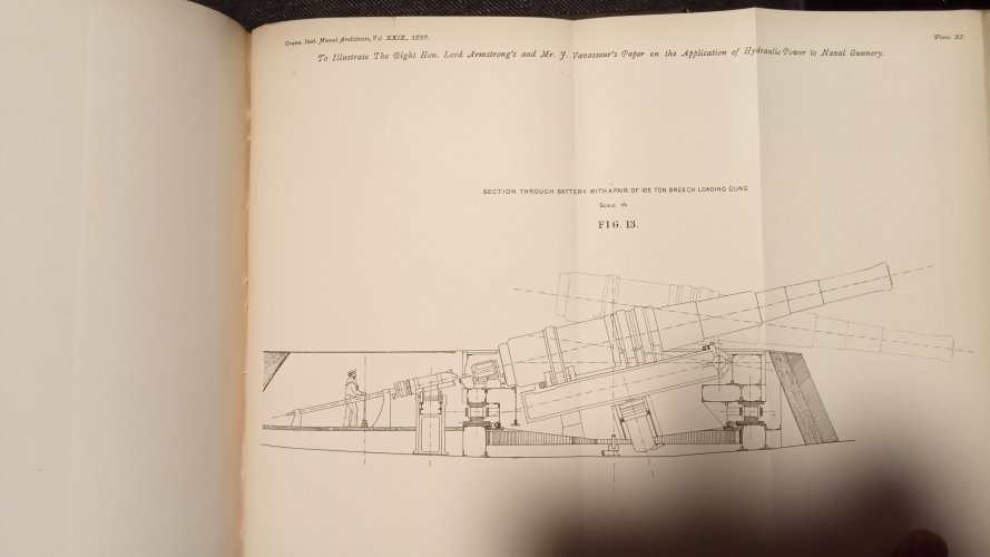

I have a copy of the Transactions of the Institution of Naval Architects 1888 which contains the paper The Application of Hydraulic Power to Naval Gunnery by Lord Armstrong and J. Vavasseur. Accompanying it are a number of gatefolds of Armstrong guns and mountings going up from 6in calibre to the huge 17in breechloaders built for the Italia and Lepanto. Attached is a photo of the gatefold of the latter mounting...

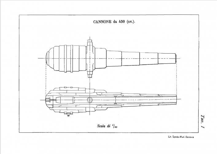

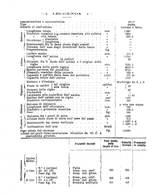

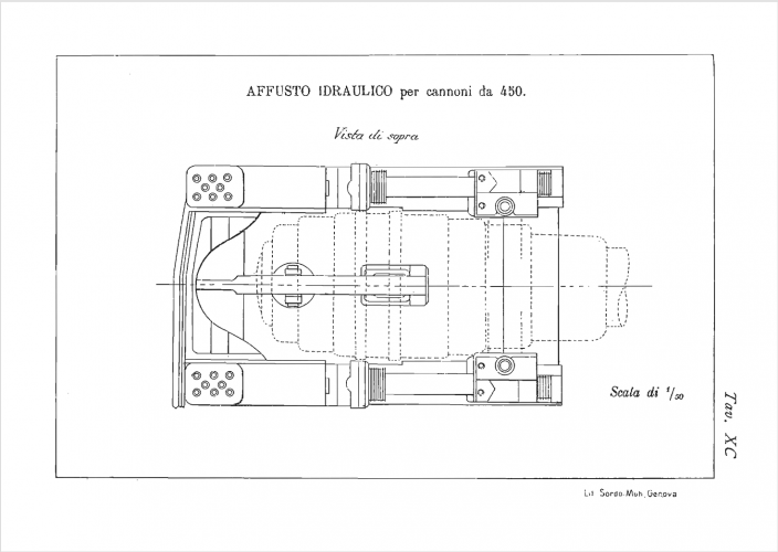

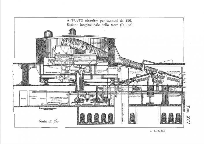

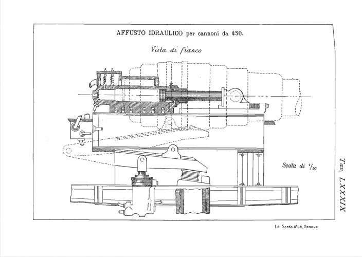

I have some material from a document I will send you via direct message, but I will post relevant pages here. The main data for the gun is on the image here, the diagrams (including turret arrangements) I will place in a spoiler:
I hope this helps!

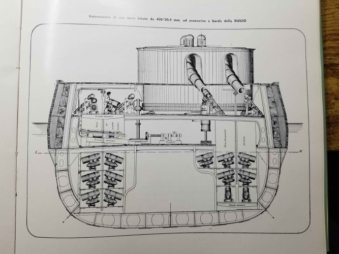

I have another angle on the turret diagram that I can share later, but I will have to photograph it or scan it from a print book.
