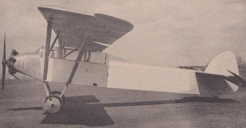

Hi all,
found this article in an old czech L+K 1970, but can´t translate him. Are this early constructions from Haller, who projected later in Germany the two amphibians Ha.22 and Ha.23? Are pics from the H.8 known? Anybody had a short biography of Haller?
Thanks and Servus Maveric

H.8 and H.9 were designed and built by the Czech engineer Oldřich Haller from Plzeň. The name of the German designer was Rudolf Haller, who worked at GMG (Gebrüder Müller Griesheim), where sailplanes and light aircraft have been built between 1924 and 1932 (e. g. GMG I, Ia, II, IIa, V).

And a small Info;
Lifelong desire to build aircraft with vertical takeoff accompanied pilsner air
engineer Oldřich Haller (1893-1953). Undertake a study of aircraft H-8 and H-9 with perpendicular
takeoff, which was nicknamed "Halleroidy". Based on studies built models on which
verified develop unconventional principle of buoyancy - propellers generated airflow bent
shaped fixed to the wings. Finally, there was a building prototypes in actual size,
which have been tested in the years 1928 - 1931 Letňany VLÚS. Haller, however, struggled with
lack of funds prevented him better engine installation
and finally the continuation of the project.

BTW: Haller's H-11 was a heavily-modified Aero A-12 reconnaissance biplane. Oldřich Haller converted this machine into a parasol monoplane aircraft with a 5-cylinder radial engine (Walter Vega?) and acrylic cockpit enclosures. AFAIK, only one H-11 conversion was made - OK-AZI.

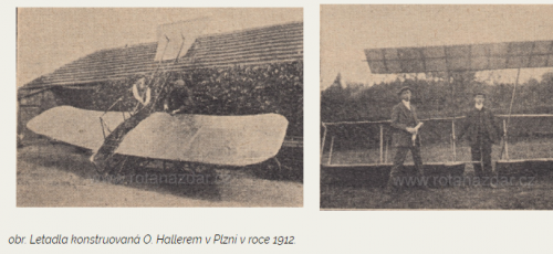

And I don't what was this,a glider ?.
I didn't found any name, but the biplane glider is mentioned as the first aircraft Heller (and his school buddy, František Šnábl) built and the monoplane glider as the second, in 1910-1911. I doubt they had any "official" name. Better pictures are here: http://slavnostisvobody.cz/wp-content/uploads/2017/02/PANEL-5.pdf

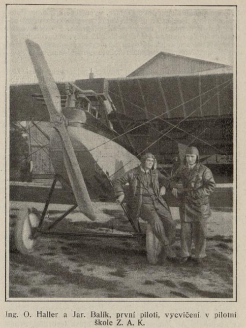

From Letectvi 1926/2,
what was this ?.
Hard to tell from such a small amount of details, but it could be late production Brandenburg B.I. Czechoslovak Air Force used several Series 176 and 276 machines, some found their way to civilian users and it is known that the Západočeský Aero Klub owned a "Brandenburg". Or it could of course be the Haller ZA-1 built as a replacement for the B-5 after Planský took it to Prague.
