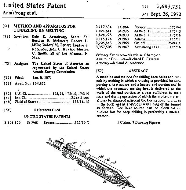

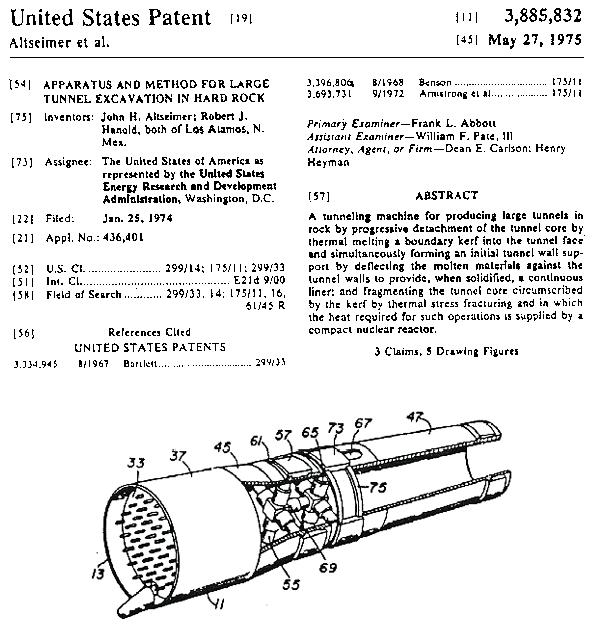

The Idea a Tunnel boring machine who melt its way true Rock by Nuclear Heat!
http://www.fas.org/sgp/othergov/doe/lanl/lib-www/la-pubs/00387371.pdf
http://www.fas.org/sgp/othergov/doe/lanl/lib-www/la-pubs/00368561.pdf
http://ntrs.nasa.gov/archive/nasa/casi.ntrs.nasa.gov/19890007687_1989007687.pdf
Nasa want it for Tunnel Moon Base
Military use to build Cheap Tunnel
