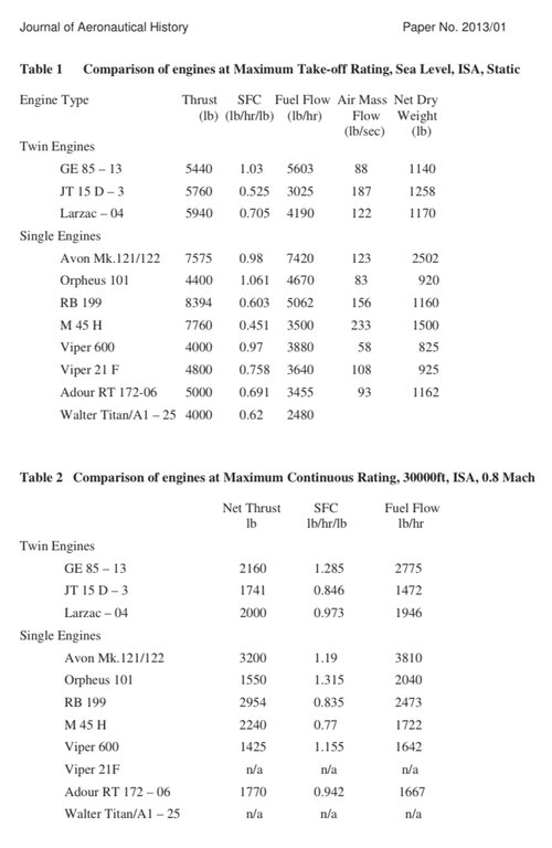

@tomo pauk Here’s an interesting list of engines that were considered for the BAe Hawk around the same timeframe (1968-70). I assume a reheat could have been added to most.
J85 was considered too thirsty. Not a lot of US alternatives available. From Europe, Adour might have been the best, but unlikely to be available given Jaguar production priority.
https://www.aerosociety.com/media/4842/the-hawk-story.pdf (see pp. 9-11)
Not a lot of US options available. Adour might have been the best, but unlikely to be available given Jaguar production priority.
Thank you for the list and pdf.
A single Adour, even with the reheat, will not add much to the table vs. two J85s. The RB.199 is the best, but I'm not sure about the availability in the early 1970s.

M45-H seems the lowest s.f.c figures for a decent thrust-to-weight ratio.

Taking a look at it by dividing the wet thrust by the dry thrust to give an idea of how much the AB boosts things... using either of the options gets you about the same 11k wet thrust on the first model of J-52.. if that stays constant over the run then the final 409 model will give you 12k dry and over 17k wet. So very J-79 like performance with a wee bit better SFC and possibly more reliable, no clue if it would be lighter or not.
