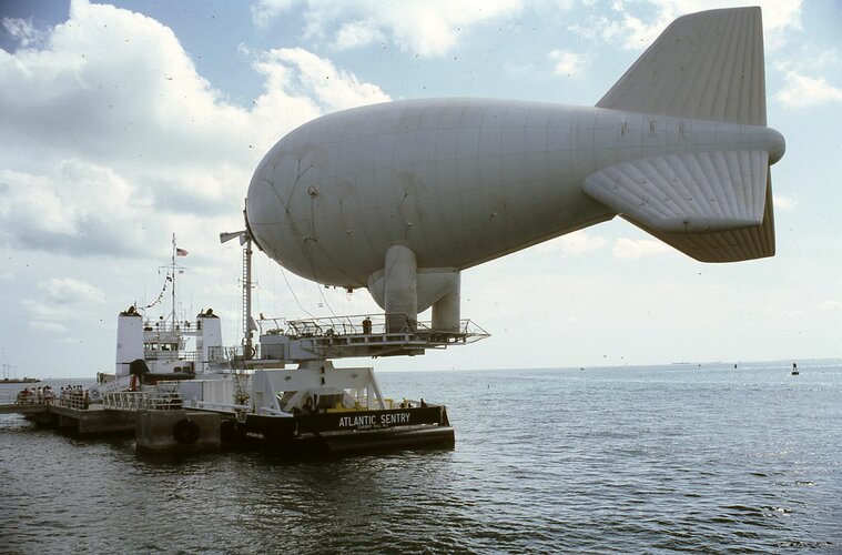

3,158
501
AEW is a mission that doesn't translate well to STOVL. Outside helos, about the only off the shelf solution that could be had is installing a radar on a version of the MV-22. And even that is a very limited platform in terms of altitude (not pressurized).
Towed aerostats.
Josh_TN
Sep 4, 2019
757
389
That seems even less ideal than a helo. Could the MQ-4's MFA be used in an air to air mode? It wouldn't be organic to the task force but the loiter time would probably allow for a 24/7 orbit. The ventral mounting is sub optimal but at 60k feet it would be looking down on other aircraft anyway.
TomS
Apr 16, 2008
4,610
1,762
Towed aerostats.
If you don't mind dragging along an ocean-going tug to tow the aerostat.

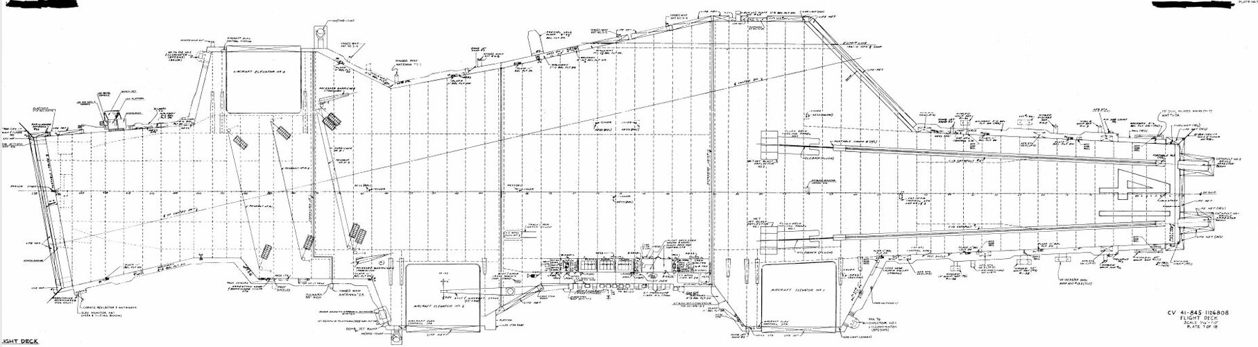

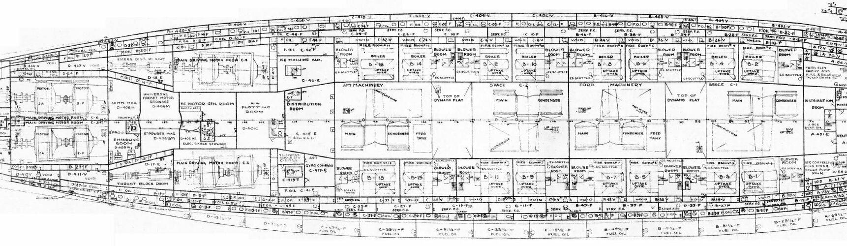

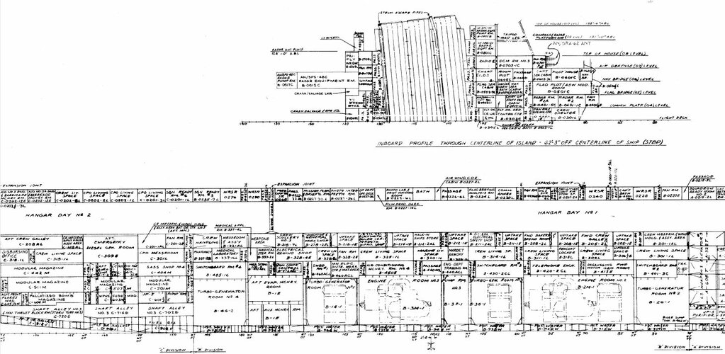

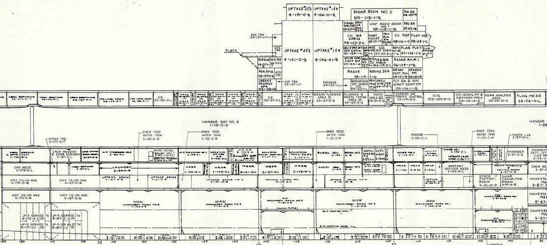

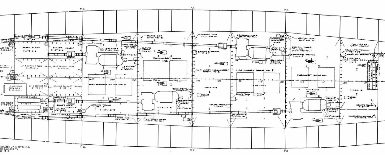

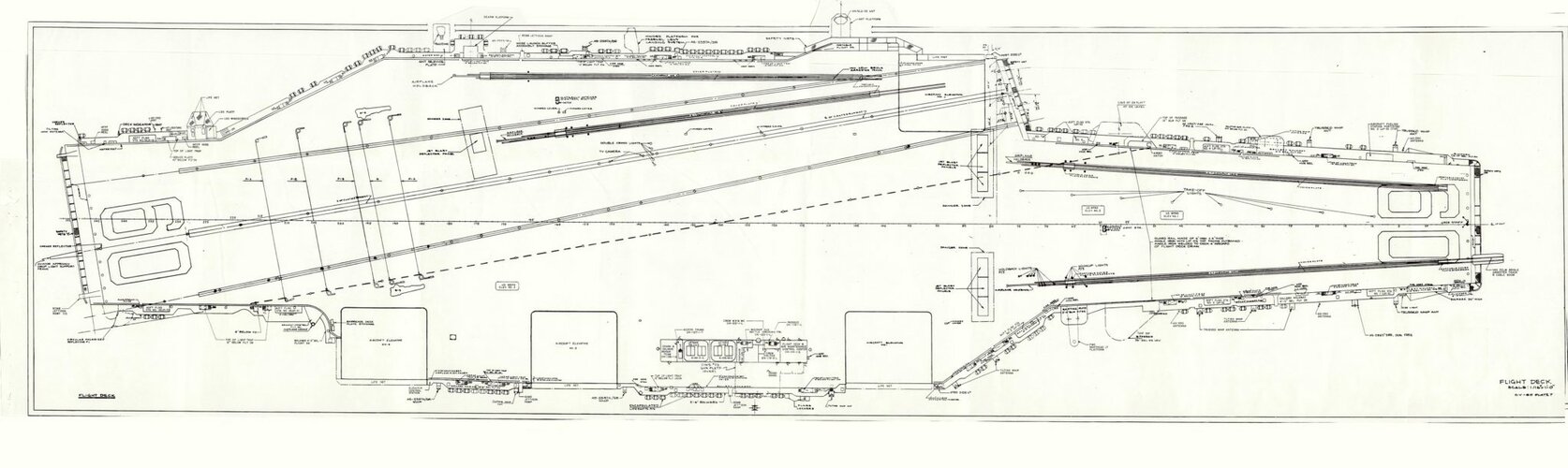

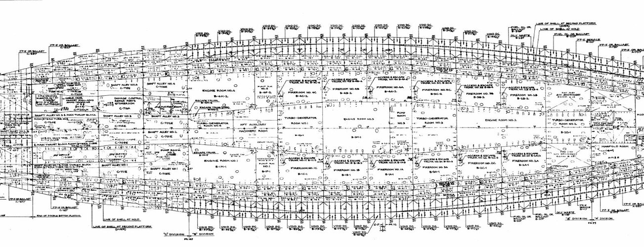

mkellytx
Sep 18, 2009
210
192
Here's JP-5 for the combustion chamber, screen captures from Midway and Saratoga's Booklets of General plans looking at the flight decks and engineering spaces gives some baselining for 60,000 and 80,000 ton carriers. CV-41 Flight Deck.JPG CV-41 Engine Rooms Side View.JPG CV-41 Engine Rooms Top View.JPG CV-60_Flight_Deck Top View.jpg CV-60 Engine Rooms Side View.JPG CV-60 Engine Rooms Top View.JPG
And the original Saratoga since she was electric drive.
