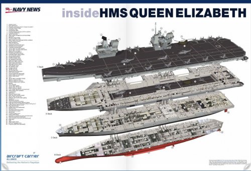

Has anybody seen any decent drawings of the CVF taht could be used as a basis for a model. Theres lots of artwork and CGI been published but very few drawings of the finalised design ::)

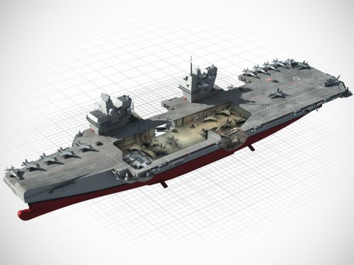

Sources:
http://media.photobucket.com/image/RGSS%20Santi/TheOriginalCooper/Carrier1-1.jpg
http://www.royalnavy.mod.uk/upload/img/CVF_STOVL_CutAway.jpg

Why is the hangar deck so small (on such a large ship)? It doesn't look like they can fit many 'planes inside (looking at the pictures) :eek:

Terry, the hanger is larger than Charles De Gaulle CVN, the design can probably hold about 30+ aircraft. Most carriers rely on deck parking to keep their aircraft capability high in the the larger US CVN's probably couldn't fit all their current airgroup of 60 aircraft in their Nimitz class hangers the certainly couldn't when they still had a flight group in the 90 aircraft range.
