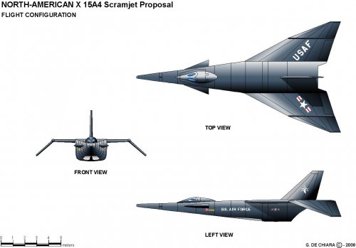

Anyway, thanks to the rough 3 views there is in Scott's unwanted blog, I elaborated this drawing about this (possible) X 15 successor.
I still belive that it could really be some competitor of X24C of early 70's.
Nothing really in common with the original X15, only the manufacturer and some know-how acquired in the previous programme.
By an architectural point of view the two aircrafts are completely different except for some "family resemblance" but nothing more....

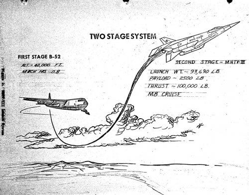

Today is my first day on on the BB and I am excited to be able to shed a bit of light on this particular subject, one which has been an area of fascination for me since I was a kid. Like the rest of you, The Rendering was the only link I had to this very interesting X-15 follow-on project and like you, I wanted to know more about it! Fast forward to the present where I now find myself working at Boeing who, by coincidence, happens to own all of the NAA-Rockwell technical library and I now have access to that store of knowledge via the computer sitting on my desk! ;D
So I have found the proposal for this aircraft, complete with many sheets of plans (yes!) but, I do not have the authority to release this information and I would like to keep my job! However, I can release some images of the 3D model I built based on that report...
The first image shows one big reason why I won't be posting the contents of the report here, it is ITAR controlled.
I can however post some facts & figures along with comments on the FP kit configuration. Also, if the members would like to ask specific questions about the contents I may be able to answer some of them.
The first thing that I should make clear is that this project had nothing to do with the X-15, except for being a method of achieving even greater speeds (M8) and that it came from the same factory. The actual project name is MHTV-III or Manned Hypersonic Test Vehicle - 3. What were versions "1" & "2"? I don't know but would be interested to find out!

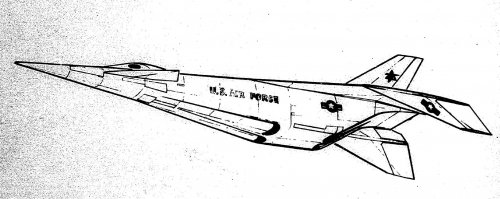

The drawing that Scott L. has is the actual configuration of the craft but it apparently is missing one detail, the rocket engine on the tail. Along with the SCRAM jet engines, the MHTV also had a single LR-91-AJ-13 engine of 100,000 pounds thrust mounted at the base of the tail (see attachments). It has a fairly extended expansion nozzle which I believe should have been visible in the NAA rendering that we are familiar with (but it was omitted for some reason). The SCRAM jets featured fixed geometry inlets and the total launch weight was to be 93,690 lb. The MHTV was equipped with two-wheeled nose gear and skids for the main gear (just like the gear on the X-15).
The report doesn't really show exterior markings other than those seen in The Rendering so we are left to our own opinions as to what they might have been. The MHTV was to be equipped with drop tanks which look to be nearly identical (I haven't actually compared them myself) to those carried by the X15A-2 so my model features a similar high-visibility scheme for them. The aircraft was to be launched from the NASA B-52 mother ships (ouch! A BIG payload that doesn't leave much room between it and the ground...) and it did feature variable-droop wing tips, just like those seen on the XB-70. My model includes hinge bullets for these tips which is a feature that I believe the actual vehicle would have had but they are not shown in the report versions of the plans. The report also shows a tail just like that of the FP kit but I believe that they would have used the typical hypersonic wedge like that used on the X-15. The fin is shown in the report with square tips at the top, not rounded as they appear to be in the FP kit. Another very minor point is that the canards have a slight curve to the leading edge, the FP kit appears to have a straight leading edge. This is not to slight the kit in any way, just to indicate differences between it and the version in the report for those who are interested in such things. The computer model seen here has been embellished with a few other textural details not found on the plans such as the treatment of the rear firewall with corrugated panels and over-board dump vents. Otherwise, my 3D version is straight from the drawings in the report.

Two questions right up front:
1: Is a three-view available??
2: What were the dimensions?

I've decided that although I cannot publish the actual report or plans, I can publish my own "plans" which you can then make your own judgment about their "accuracy" (wink, wink, nudge, nudge...). Give me a few days to tr, er, "prepare" them.
It should be noted that this was only a "preliminary" proposal which, if it had been accepted, would have then spawned a true engineering proposal and that is when the wind tunnel work would have begun. Only then would the flight configuration begin to emerge. What is contained in the report and is represented by The Rendering is nothing more than an engineering "sketch" or "estimate".

The shape seen on the side of my rendering is not a conformal tank, it is just the shadow of the drop tank. It does look like a tank though!
I worked feverishly to get this drawing ready for the weekend so I hope everybody enjoys it. The layout is proportioned for an 11x17 print. Now you know what the NAA MHTV-3 was supposed to look like. Have a good weekend and if you'd like to talk to me in person, you'll find me showing people around at the Yanks Aircraft Museum at Chino (CA) Saturday between 11:00 & 4:00.

Submitted under contract no. AF 18(600)-2751 (I'm not sure about the 8). I don't see a date.
Phil's MHTV-3 stuff from North American is dated 1968.
So we have MHTV's from Lockheed, McDonnell (not sure of the date) and North American where Lockheed and
North American are discussing MHTV in the later 1960's (1966-1968).
And we have a McDonnell AF contract number.
