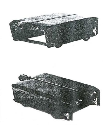

But a torpedo armed motor boat is actually a very good idea for coast defence at the moment. But it would have to be a submersible boat. Current fast attack craft are highly vulnerable to naval helicopters armed with guided missiles. MH-60 with Hellfire and Lynx with Se Skua and so on would (and did) make an absolute mess of the various fleets of FACs. The only defence against this is loading lots of anti air capability onto your FAC making for a corvette or hiding the FAC from the surface search and attack helicopters.
I’ve always thought there was a lot of potential in the WWII German design for the Manta mini submarine. It has excellent surface mobility for getting from A to B and can submerge for stealth. Update something like this to a reasonable size and add some missiles and/or torpedoes and you would have a far more capable coast defence weapon than the current fleets of helicopter bait.
