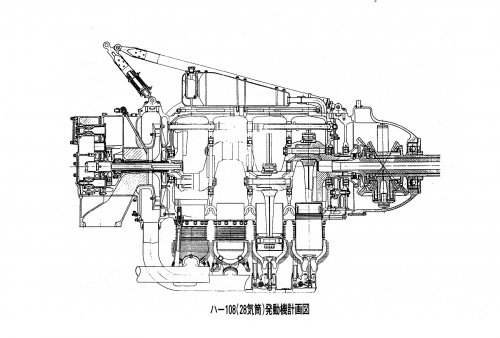

Hi! Mitsubishi HA108 28 cylinders air cooling engine.

Hi!
Mitsubishi HA108(HA53-01,MK11A)
Displacement ; 69L, Take off power ; 3400hp/2800rpm, 3100hp/2600rpm/1000m, 2880hp/2600rpm/6500m, Diameter : 1285mm, Weight ; 1850kg, Bore ; 140mm, Stroke ; 160mm, With mechanical 2 stage 2 speed supercharger, Contra rotating propeller.
http://www.warbirds.jp/kakuki/sanko/en_japan.htm
Wow! So a banked radial like the AW Deerhound or the Alfa L101 rather than a 4 row type such as the Ha 54 or R4360.
May I ask, where did you get this drawing?
