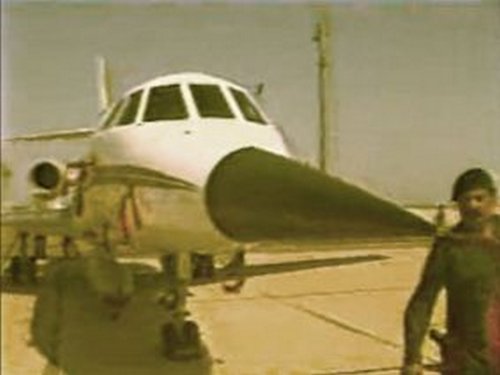

For lack of a topic on armed civilian planes, I'll just leave this here. While not specifically on an armed Learjet, this article is on a related note.... that of an armed business jet.
In this case, an Iraqi Falcon 50 bizjet retrofitted to carry Exocets. It appears to have been the plane that attacked the USS Stark in' 87.
https://warisboring.com/in-1987-a-secret-iraqi-warplane-struck-an-american-frigate-and-killed-37-sailors-b341a948fa21#.fgl2yxocg
