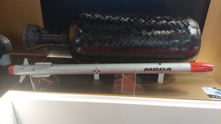

It's the Counter Mass Interceptor as it was already mentioned here. And as for what it physically is as a missile, it's essentially a CAMM-SR that I remember someone in this thread was advocating for. MBDA UK's low cost IIR seeker, WITU's 105 mm rocket motor, range of "over 6 km", though when I talked with people from the WITU stand they were quoting up to 7-8 km if I recall. Cold start also, similar to the CAMM, but with the turnover pack (with 6 motors) being jettisoned by the ignition of the main rocket motor instead of being integrated into the missile like on the CAMM. The launcher itself is a Polish proposal, actually older as a concept than the cooperation with MBDA, and despite being angled, it's essentially a vertical launcher in that it doesn't rotate and the missile is positioned towards its target after it leaves the tube. As of now it's the only launcher they are planning to integrate the missile with (I've asked specifically about the one on the HMT, from Farnborough, and they said they have persuaded MBDA away from that idea), but WITU has also developed a hardpoint for aircraft integration, mainly with unmanned systems in mind. They're aiming at a price of around 75 000 USD, so quite cheap for the missile's planned performance.

And here are some pictures of the CMI that I took, including the brochure they gave me:
