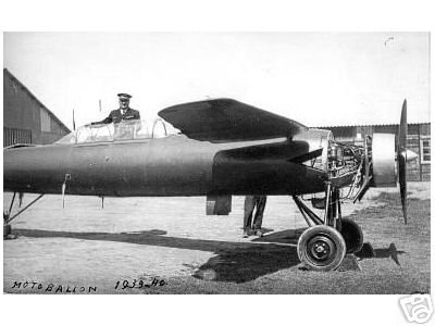

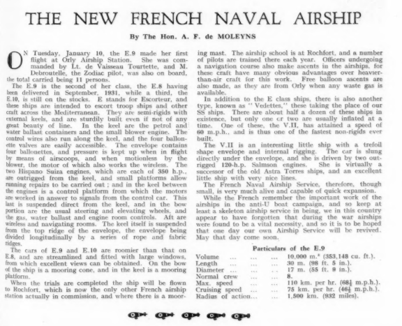

I am trying to confirm the manufacturer of the E.9 French Navy airship from 1933. The E denotes Escorteur (Escort).
The type features in two YouTube videos, one of which calls it the Zodiac E.9 but I understood the Zodiac types ceased airship production around 1913.
The E.8, E.9 and E.10 are mentioned in a Flight article as well (see image), where Zodiac is also mentioned.
The pilot of the E.9 is given as Monsieur Debroutelle and a Pierre Debroutelle invented one of the first prototypes of the Zodiac inflatable boats in the late 1930's.
Would some of our French lighter-than-air experts be able to confirm the manufacturer?
Apologies if this type is on the forum elsewhere but E.9 does not return very much in the way of Airships!

Flight 26 January 1933 issue

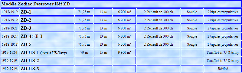

They produced the ZD (Zodiac-Destroyer) successful models, and even exported some to the US Navy after the war: ZD-US-1 and -2.
(table credit @Marc_91 on aviation ancienne)
Then Zodiac went on to produce the Escorteur series in the interwar, and the MBZ which served into WW2.
Moto-Ballon Zodiac MBZ-3 1936:

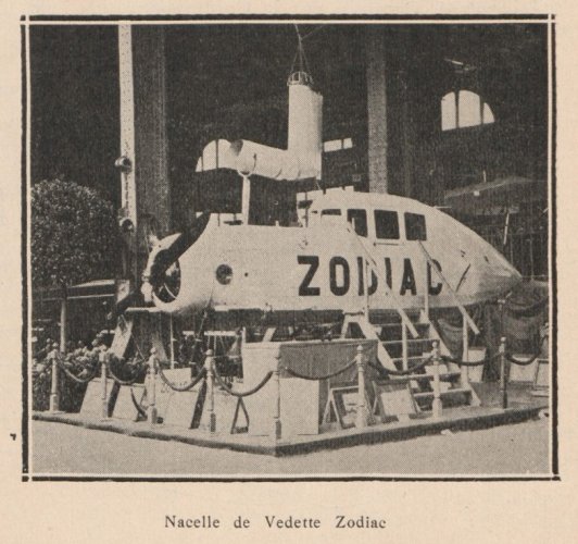

Exactly. Here are two images showing an Zodiac-built airship nacelle from 1922:

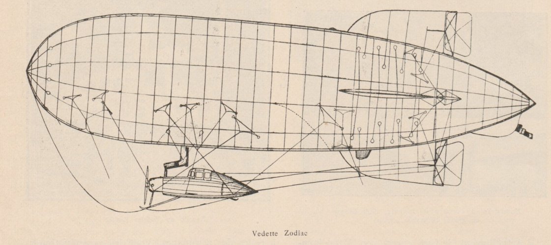

Also from 1924, a Flight article on the V.Z.24 "Vedette":
("V.Z." meaning "Vedette Zodiac"—no connection with Zeppelin whatsoever!)

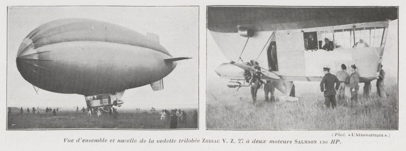

A December 1931 item on the V.Z. 27:

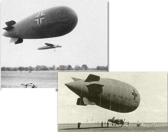

Indeed. Also during ww2. Their products were appreciated not only by the French military, but also by the tourists:
An unfortunate Moto-Ballon Zodiac MBZ-3 as Nazi beute, ca 1941.
Zodiac dirigibles were adopted by the military of many countries, even before WW1. They served with the French, Belgian (Zodiac II & III), Dutch (Duindigt), pre-Soviet Russia (Tchaika, Korchoune), USA (Navy VZ-3, -7, -13, Army RN-1), and Nazi. Maybe others too.
