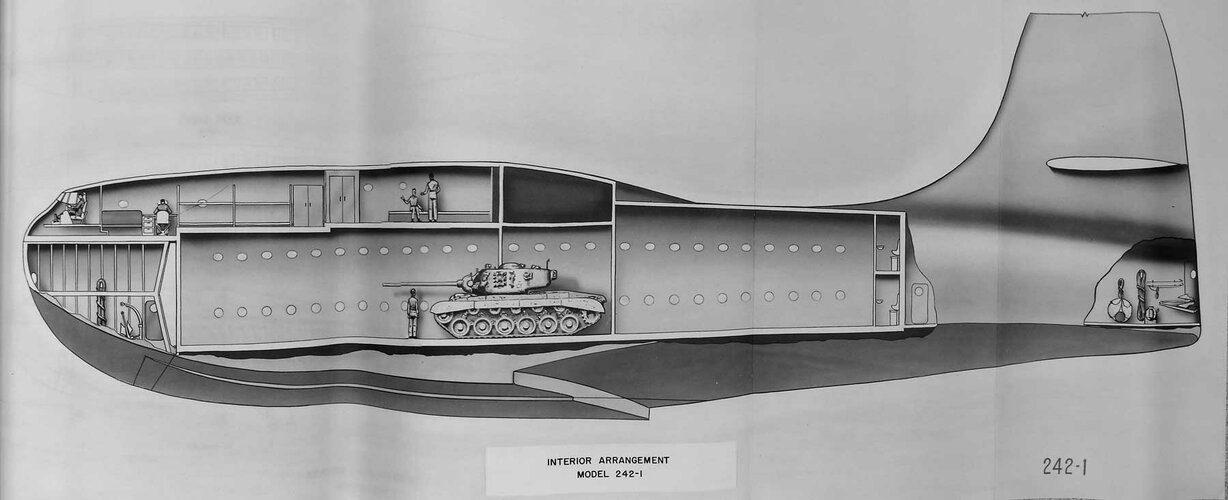

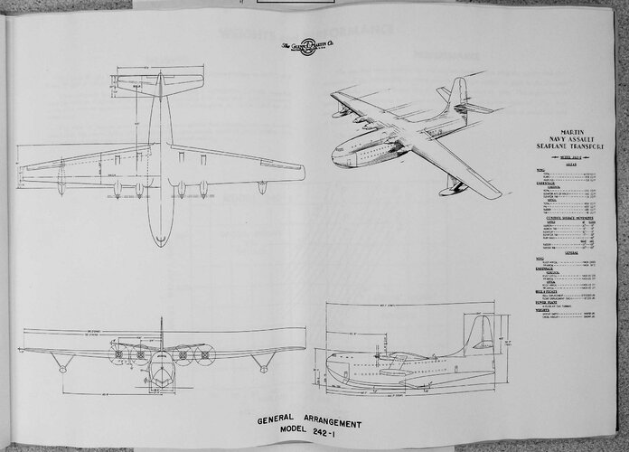

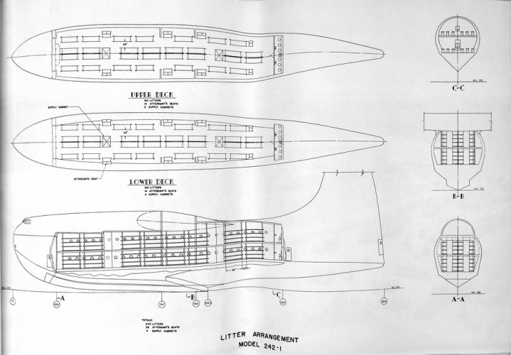

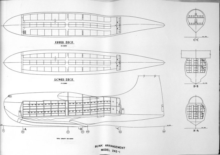

On a recent research trip for one of my projects, I came across these of the Martin 242-1 Assault Seaplane Transport. It was to be powered by four MENASCO L-1000S propeller drive gas turbines and had an estimated gross weight of 334,947lbs!
I was unable to obtain enough weight to flatten the drawings, so apologies for the nice curves in the middle of each image. I hope they are of interest none the less.

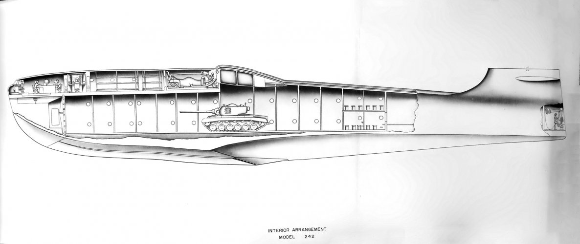

Another image that I captured is the interior arrangement of the 242-1.
In case you wondered, there is a 242-2 that I will post when I get the images ready.

Martin general arrangement diagrams were always pretty distinct... you knew who they were by even if stripped of data and logos.

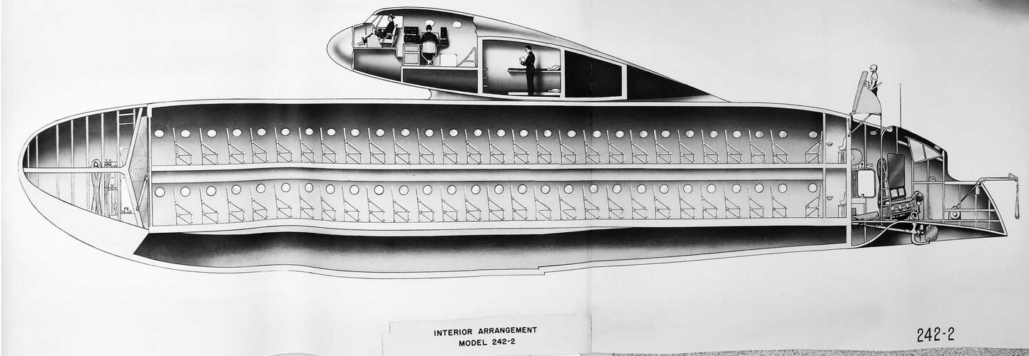

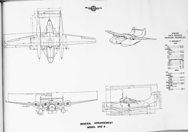

The Martin 242-2 proposal offered a different layout. Having twin booms and an "Assault Cargo Hull" that detaches from the aircraft. Same engine configuration as the 242-1 with a gross weight of 381,887lbs. Not a light weight by any measure. Again apologies for the rolled look, these had been stored in a folded condition for many years, are thick and with the current setup I was unable to obtain satisfactory means of flattening them out to scan/photograph. Maybe next time!

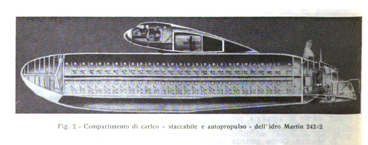

From, Rivista marittima 1954.
