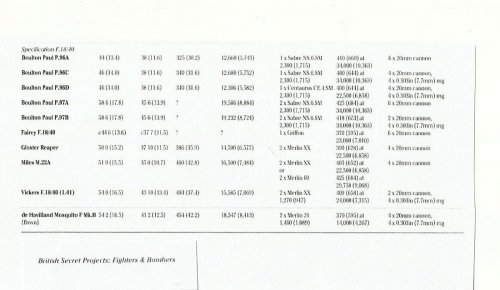

Hi all
I'm curious !!
from " British secret projects fighters and bombers"
list of the spec 18/40 competitors ?

Bonjour hasan
Well, if I understand my list is not complete !
Thank you-Bye

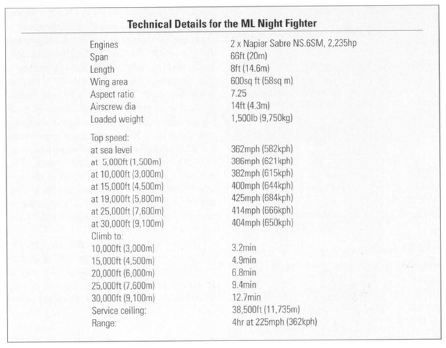

Bit additional info.
A simillarly powered (same engines as the Boulton Paul P.97) twinboom fighter was also designed
to Spec.F18/40 by R.Malcolm Ltd. of Slough.
It was designated the M.L.Night Fighter,using the intials of it's designer
Marcel Lobelle. M.J.O.Lobelle has been a Belgian refugee during WWI, and had become
Fairey's chief designer in 1924,joining R.Malcolm Ltd. just before the war.
The ML. Night Fighter was submitted for consideration in January 1941 and had a far
more radical engine and armament layout than the P.97. etc...
page 103 of the afore mentioned book.

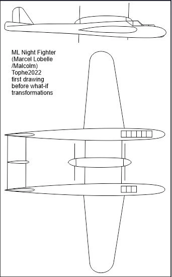

My dear Tophe makes a wonderful drawing to it,
many great thanks to him and God bless him.
