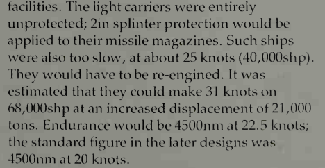

Given these figures how practical is doing extensive modernization of either Majestics or Centaurs as opposed to building a new ship which presumably would have both lower maintenance/refit costs and likely require at least a somewhat smaller crew? if you calculate total lifecycle costs?
Has anyone estimated how much a newly built 20,000t or 27,000t carrier would had cost in 1960?
IIRC Hobbs, Friedman and maybe Brown have estimated costs of the early 1960s Escort Cruiser designs.
Brown lists 30-36 range for building, 38 with VSTOL capability.
Scratch that, it's for later designs and probably different rate of pound.
