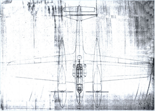

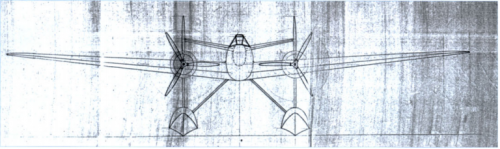

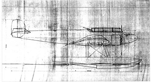

Great find my dear Silencer,
and we can put them here.

Aer.Macchi C.203
Aer.Macchi C.203: An intruder among the aircraft of the 200 series?
By Giovanni Massimello (Translated by Leonardo Pavese)
After the emersion of the Macchi C.204 from piles of yellowed sheets of paper, we just needed to find out some information about the model C.203 to be able to complete the series of Dr. Castoldi’s designs, which began with the Macchi C.200.
One could have expected that – under the designation C.203 – some evolution of the C.202 would pop up, maybe with a new fuselage redesigned to house a Mauser gun firing through the shaft of the Daimler Benz 601A engine, like in the Messerschmitt Bf109. This modification, notwithstanding the pressure of Benito Mussolini who wanted a “fighter-cannon” now, could not easily be made in the C.202, due to inescapable weight and balance problems. A new design would have been necessary, with new tooling and a new assembly line. All that was hard to accomplish in a short time, and therefore nothing was ever done. Perhaps, one could also have envisioned the C.203 as a preliminary project to replace the DB 601A of the C.202 with a more powerful engine.
Nothing of that kind.
The C.203 was actually a design of a twin-engine seaplane, destined never to leave the drawing board.
Aer.Macchi entered the C.203 project in the 1937 ministerial contest for a high-speed reconnaissance seaplane. The other competitors were the Caproni Ca.124 and Ca.410, the IMAM Ro.55, the FIAT-CMASA RS.14 and the CRDA Cant. Z.510. The winner of the competition was the RS.14, and the design of Dr. Stiavelli went on to series production.
Dr. Castoldi of Aer.Macchi, who undoubtedly knew seaplanes, had designed a slender twin with pontoons, with a twin tail and armed with three machine-guns: one fixed in the nose and two swiveling ones, one dorsal and one ventral. The section of the fuselage of the seaplane was very thin, with seating in tandem.
The wingspan of the C.203 was m 20,9 (ft 68 ½) and the total length was m 14,34 (ft 47). The engines were very likely the omnipresent FIAT A.74. For comparison, the RS.14, which was very similar and used the same engines, had a wingspan of m 19.54 (ft 64.10) and was 14.10-meter long (ft 46.2). The most obvious difference was the lack of a windowed bow in the C.203; a non-insignificant feature in an aircraft designed for “fast reconnaissance.”
