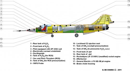

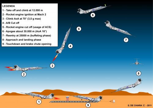

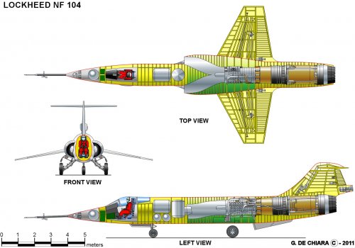

Archipeppe,
You have done it again....beautiful work.
Now THAT is the way to fly...J79 plus rocket power. What a wonderful aircraft.
Awesome !
How did the F-104A go to 103 000 + ft did it also have rockets ?
topspeed3 said:
Awesome !
Yes - one tail-mounted rocket motor - as the beautiful drawings above illustrate. -SP
Typo in the picture, the RCS also used H2O2, not "H2O4".

I think the main intention of the NF-104A was not to just operate at higher altitude, but to train future space plane pilots in the use of things like rocket boosters and reaction controls.
