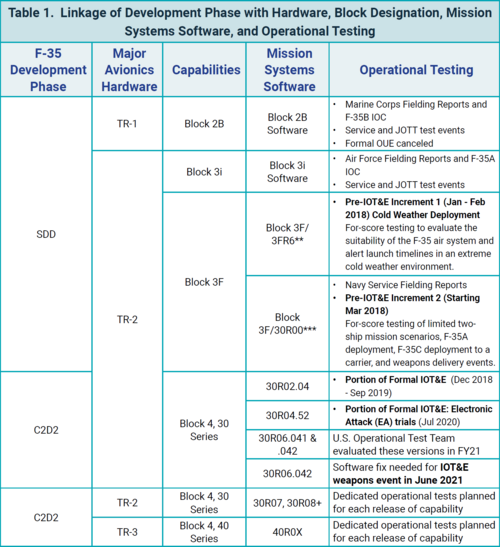

To further clarify a bit more about F-35 M-C to those who are still a bit puzzled, it is because the current phase of the JSF program, the IOT&E is technically a part of SDD phase (an EMD equivalent from the ATF program), although the program itself transited from SDD to IOT&E phase back in 2018.

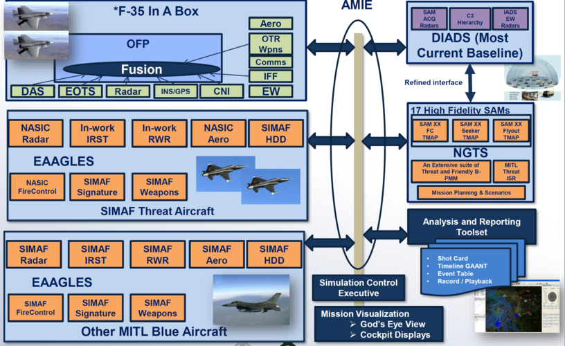

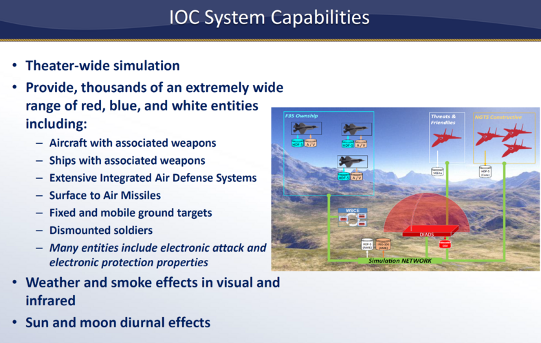

Due to the complexity of F-35 and its underlying systems, some of its capabilities are to be verified/certified on a virtual, highly sophisticated computed environment called the JSE. Development and construction of the JSE itself as well as integrating the F-35 model to the JSE have been delayed up until now for various reasons, some discussed on this thread earlier. In short, JSE is a critical component of the JSF IOT&E campaign so a delay in JSE means delay in IOT&E and a delay in IOT&E means delay in conclusion of SDD (development of F-35). Without a conclusion of SDD, JPO cannot declare M-C for the JSF program and without M-C it cannot enter FRP.
Apart from that, as I've mentioned before, both the Capitol Hill and the AF are more keen on waiting for Block 4 (no one want to pay extra dollars to pay for retrofitting brand new aircrafts) as well as further observing F-35 procurement and sustainment cost trend (LM says it will go down, it is going down but no one knows if it'll go down enough. Also recently they've hinted that the numbers will temporarily go up due to supply chain disruption and reduced procurement by USAF). We'll get a better picture once we reach the mid 2020s, the point on which LM claimed the F-35 will reach the short-term sustainment cost reduction goals. Don't be surprised if USAF again touts the idea of MR-F in a few years if LM cannot.

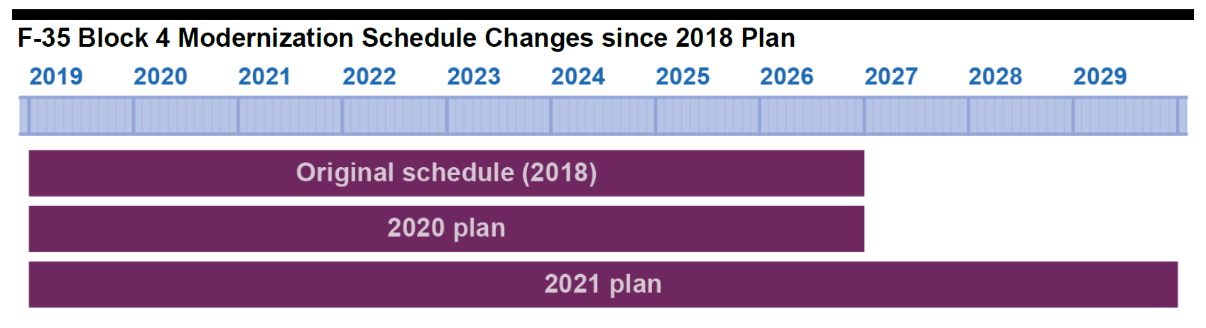

Yup. TR-3 will be implemented starting lot 15. Problem is that C2D2 software implementation is, imo, at least half or more the entire Block 4 program. I'm not sure if the plans to get all Block 4 hardware implementation by lot 17 is still the plan, for which I cannot comment upon, but even if that's the case I'd think that the AF/JPO and CH will all want to know which direction the AETP will proceed since it is also integral in providing Block 4 capabilities their required power and cooling.
Just to be sure everyone's getting the same picture, here are two diagrams that could help understanding current C2D2 developments and different F-35 versions.
