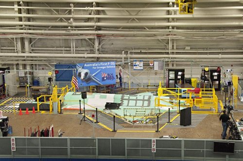

Northrop Grumman Delivers Center Fuselage For Australia's First F-35 Lightning II
(Source: Northrop Grumman Corporation; issued October 3, 2013)
PALMDALE, Calif. --- Northrop Grumman Corporation delivered the center fuselage for Australia's first F-35 Lightning II aircraft to Lockheed Martin on Sept. 23. This center fuselage will be integrated into a conventional takeoff and landing variant of the F-35 and represents the first of 100 center fuselages that will be manufactured at Palmdale for the Royal Australian Air Force.
"This center fuselage will be incorporated into the first F-35 for the Royal Australian Air Force and will be delivered in 2014 for pilot training," said Brian Chappel, vice president of the F-35 program for Northrop Grumman Aerospace Systems sector. "The first Australian center fuselage was inducted into our Integrated Assembly Line (IAL) at Palmdale last October and now we've delivered it, marking yet another milestone achievement for the F-35 program."
As one of eight international partners on the program, Australia joined the F-35 program in 2002 and has made significant contributions to the design and development phases of the program.
Northrop Grumman's IAL maximizes robotics and automation, providing additional assembly capability while meeting engineering tolerances that are not easily achieved using manual methods. The IAL is central to producing the F-35's center fuselage as well as increasing the program's affordability, quality and efficiency. Currently, there are 35 center fuselages in flow on the IAL, including another center fuselage for Australia.
As a principal member of the Lockheed Martin-led F-35 industry team, Northrop Grumman performs a significant share of the work required to develop and produce the aircraft. In addition to manufacturing the F-35 center fuselage, Northrop Grumman designed and produces the aircraft's radar and other key avionics including electro-optical, communications, navigation and identification subsystems.

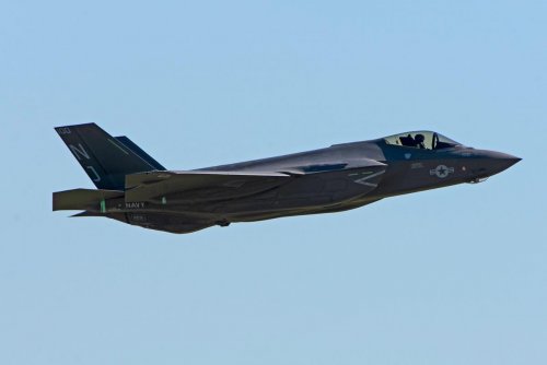

PATUXENT RIVER, Md. --- The Navy variant of the F-35 executed the first airborne separation test of an inert weapon on 21 October.
Marine Corps test pilot Capt Justin Carlson flew the F-35C test aircraft known as CF-2 over an Atlantic test range when he released the 500-pound inert Guided Bomb Unit-12 (GBU-12) Paveway II laser-guided weapon from an internal weapons bay. With Monday's weapons separation, all three F-35 variants have released ordnance from their weapons bays.
The F-35C carrier variant of the Joint Strike Fighter is distinct from the F-35A and F-35B variants with its larger wing surfaces and reinforced landing gear to withstand catapult launches and deck landing impacts associated with the demanding aircraft carrier environment. Initial carrier trials for the F-35C are scheduled for 2014.

As Australia's first F-35A – commonly known as the Joint Strike Fighter – rolls along the assembly-line, Air Force’s first F-35A squadron is on track to be operational in 2020, according to New Air Combat Capability Project Manager Air Vice Marshal (AVM) Kym Osley.
AVM Osley was at the F-35A manufacturing plant Fort Worth in Texas recently when the RAAF’s first F-35A came together. “They put the three parts of the fuselage together and installed the wings,” AVM Osley said. “We expect the first Australian F-35A to come off the production line in July 2014 and the second in August 2014.”
After production is complete, the jets will fly to Luke Air Force Base in Arizona to be used in the pilot training pool. “They will be integrated into a US Air Force squadron as part of the pilot training continuum,” AVM Osley said. “We expect our first Australian pilot to start training in early 2015. There will be more people training in the years after that and we expect our first aircraft to be in Australia in 2018.”
The first operational squadron of F-35As, which will be No. 3 Squadron, should be up and running by the end of 2020. AVM Osley said the new F-35As came in slightly less than the expected $130 million for each aircraft and future aircraft were expected to reduce further in price. “It is pleasing to see that the program has been able to get the price of the aircraft down, with the aircraft costs in each successive annual production run coming in below the previous year, and below US Government estimated costs,” he said.
