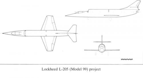

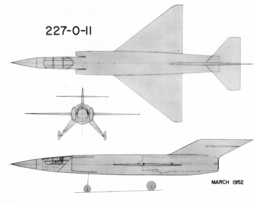

Any drawing of this project ?
Most likely one of the missing links between the F-90 and the F-104. Lockheed's LRI-X entries also fall into this evolutionary thread.
There is a 3-view in the appendix of Miller's Skunk Works.
Someone is faster ;) I only hope that it is the right picture, because I found it not in appendix, but at the beginning of chapter 5.

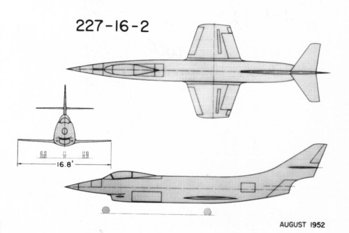

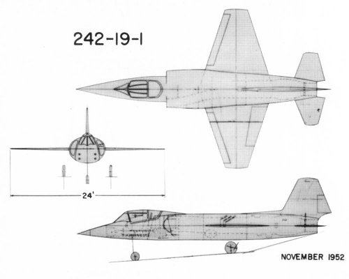

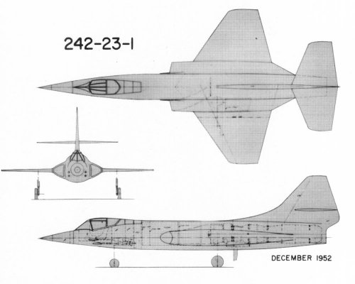

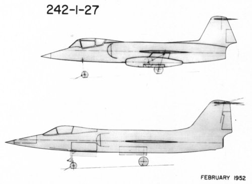

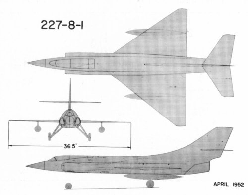

PS: I have a lot of pre-F104 studies, but not any available time now, so I will scan and post them sometime during weekend.

Actually, the appendix is of Francillon's "Lockeed's aircrafts since 1913"... BUT, it has a nice description... ;) 8)

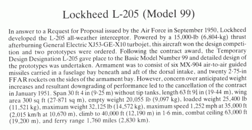

The J-53 engine... :) I heard it developed around 17 000 Ibs
(8000 kgp) of thrust in 1951-53 but was too big and abandoned (Le Fana de l'Aviation, la deuxième génération jets)
Nice to see a fighter project with this engine :p

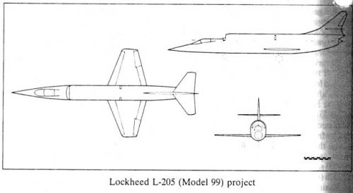

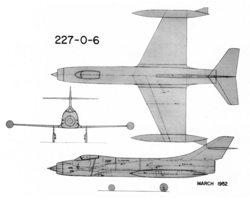

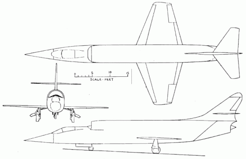

GOT IT. ;D As soon as I can, I'll get the picture scanned. There's a 3-view in Putnam's(?) book on Lockheed aircraft. It's also refered to as the Model 99.
And a reply for elmayerle, if you're refering to Jay Miller's 'Skunk Works...Offical History', no, the L-205 is not pictured. They skipped the -205 and only showed the -204 and -206. I have that book and checked three times.
;D
Here you go!
Credit goes to a history book on Lockheed, by Putnum. I forget the actual name. I made this copy at the library over a year ago. ;D
Okay, so? It was late and I had the picture with me. So, why not? At least it gave me a good idea of how my scans turn out. Practice, practice, practice.... ::)

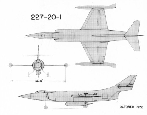

The nose is already F-104 :D Now, change the position of the air intake, shrink the whole aircraft and you obtain "the missile with the man in it"
I know dear Matej spoke about that projects before but
there is the same projects from Flightglobal.
http://www.flightglobal.com/FlightPDFArchive/1961/1961%20-%201518.pdf

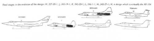

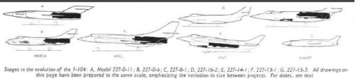

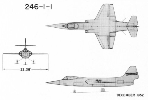

Not directly. Fight global shows the Starfighter evolution
as a light weight air superiorty fighter wile the
L-205 was Lockheeds answer to an Air Force ,September 1950, request
for an all-weather interceptor...
Actually for a missile-armed interceptor (late 1950), an RFP cancelled in 1951 (Bill Slayton dixit...), which is not the same as the famous "1954 interceptor"... Another possible tender for the missile-armed interceptor is the V-374, an USAF derivative of the F7U-3.

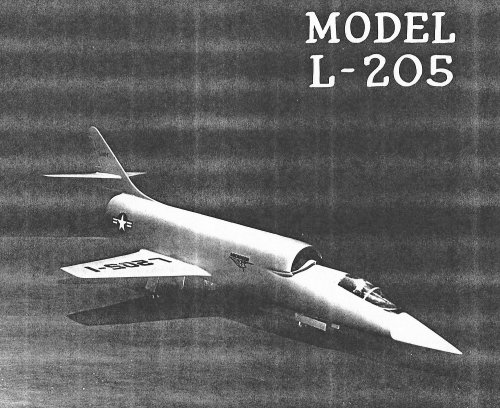

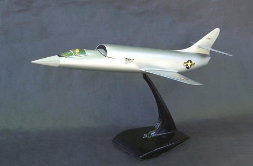

Poor quality image of a model of the L-205.
Same, but in color.

I like yours better :)
