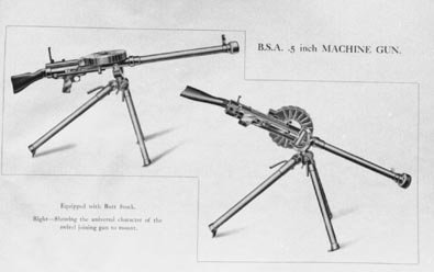

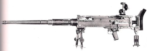

AAI lightweight HMG, BSA Model 1924, MAC-58.
Of course, the Kord and the newest Chinese HMGs can be considered lightweight in my opinion, especially compared to the venerable M2 and DShK.
Additional info on the Robinson piece would be much appreciated, too.

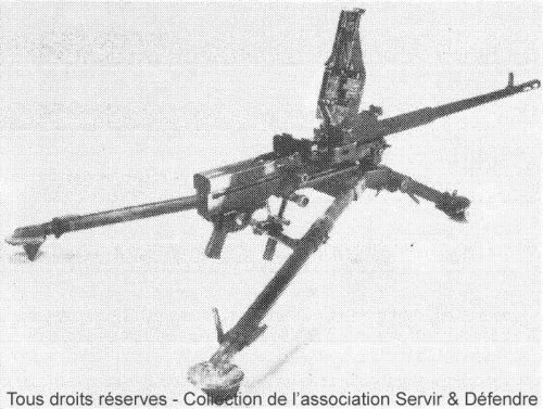

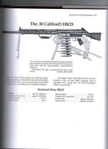

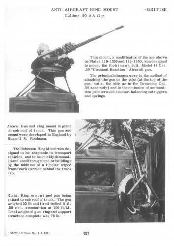

There is a link on the Robinson machine gun but i'm not sure if it's true or not . http://fnfal.com/forums/showthread.php?t=76174
The hk25 , sr14 and dover devil are mounted on GPMG tripod ( 8 kg) .

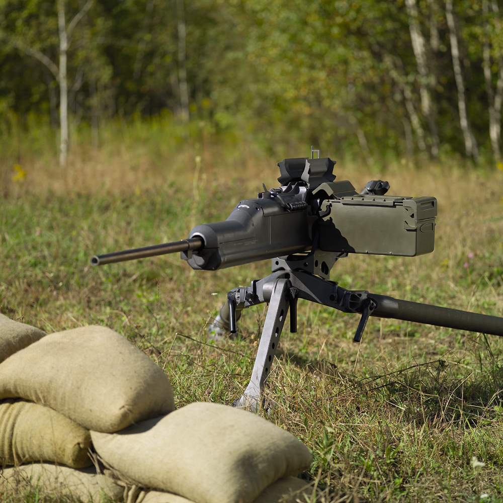

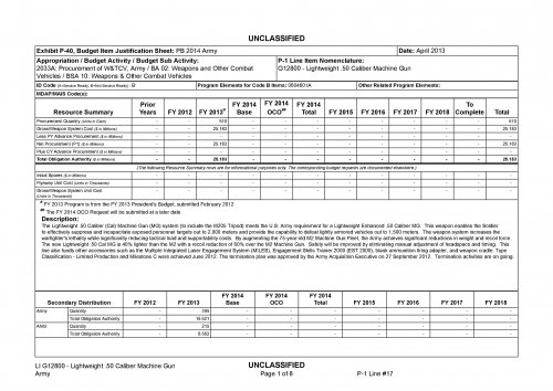

General Dynamics XM312
http://world.guns.ru/machine/usa/xm312-50-cal-e.html
and its successor
General Dynamics XM806 LW50MG
http://world.guns.ru/machine/usa/lw50mg-e.html

Here's a promotional clip of the GD LW50MG, note the low rate of fire and apparently very well mitigated recoil. I can see a role for such guns as a UAV-based semi-auto sniping weapon as well.
http://youtu.be/rLYa0uA7OG0

Robinson S.R. model 14 cal 50 and hk25
wow, thank you Tround for confirming HK 25 idea was not and internet legend..

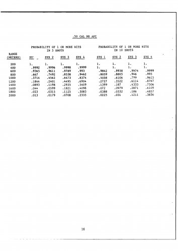

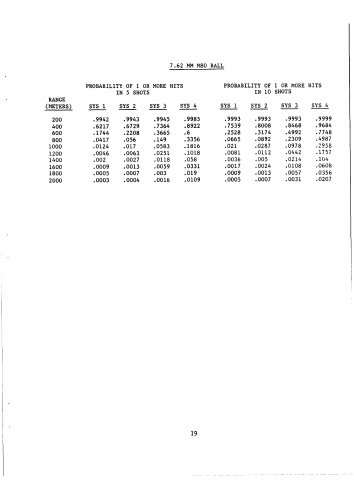

There is a requirement for great ranges . 2000 meters against personnel and 1500m against APC . The heavy weapons need great ranges in the purpose of extend the cover of small units (squad etc).
The mechanism of the penetration is independant of the media : Velocity , sectional density , diameter .
The 0,50 is more versatile and it is what the armies need . The 0,50 can suppress many covers that the 0,338 can't , particulary at long range .
There is little difference in accuracy , in short burst between a M60 and a M2 . (system 1 in the document : iron sight ) . An 0,50 machine gun with a quick change barrel is not disadvantaged and you need more time to aiming than any other tasks .
the document :"FIRE CONTROL ANALYSIS OF SELECTED CREW SERVED WEAPONS" DTIC

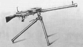

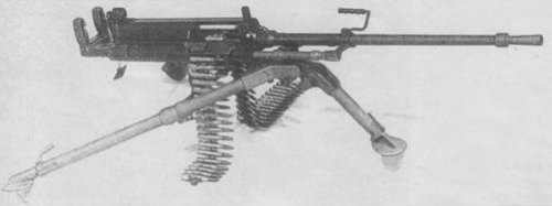

Do you have any further information on the AAI 12.7mm Lightweight HMG? Or can anyone here point me at a post or somebody who does happen to have that information?

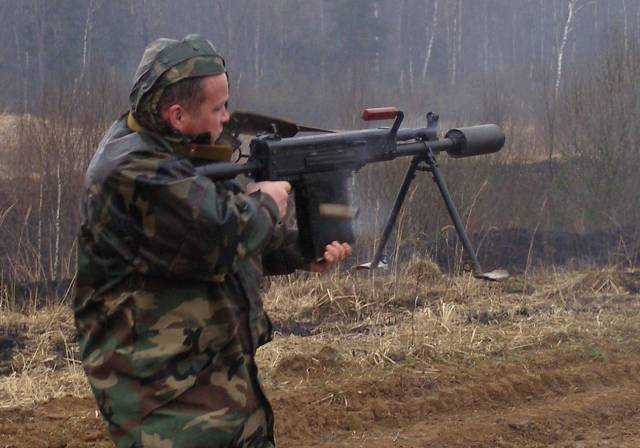

Funny titbit. 12,7mm hand-held magazine fed MG...
6P62. "Only" 15kg empty. And it can fit almost 15 rounds!

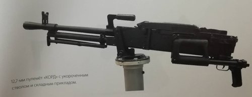

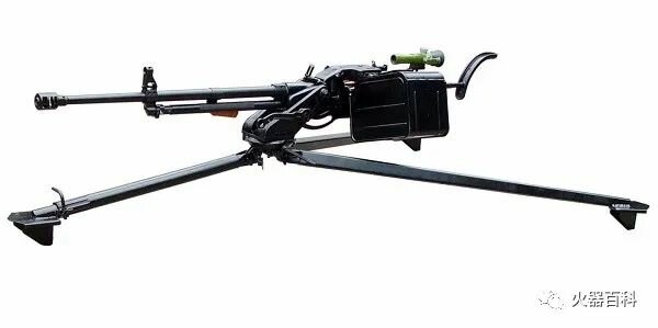

Also, Kord-R. 18.5 kg, and, 14 or 20 rounds.

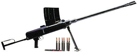

Barishev KPB - 13.2 kg, 16-round magazine (1962 - 1980th):

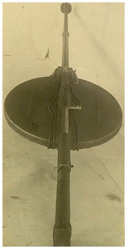

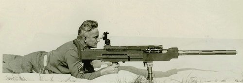

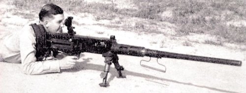

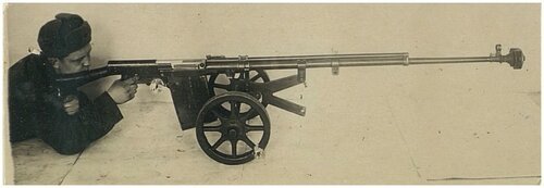

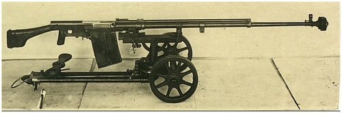

While not exactly qualifying as lightweight .50 MGs, here's a couple interesting interwar oddities: the Browning M2 "Anti-Mechanization Weapon" courtesy of Forgotten Weapons.
These were pretty much exactly what they look like: shoulder-fireable M2s for anti-materiel use, or basically an attempt at making an M2 into an antitank rifle. Like the rest of the antitank rifle family they were eventually just deemed too huge and heavy with no real benefit over a regular tripod or fixed mount.
And of course there's the Kord 12.7, weighing in at a heavy but manageable ~65 pounds in its lightweight configuration, and looking damned impressive when fired from the hip.
Not sure about AAI, but they have worked with ARES in plastic-cased telescoped ammo systems.
Before that, ARES developed the .50 PCTA (Plastic Cased Telescoped Ammunition) in the mid/late 1980s which matched the performance of the .50 BMG round but with weight reduced by 33%. To use, it they first developed TAMG (Telescoped Ammunition Machine Gun) with a 40% reduction in the weight of the M2HB, and then the TARG (.50 cal Telescoped Ammunition Revolver Gun) for aircraft use. Both weighed around 45 lbs (20.4 kg) but the TARG was designed to fire at 1,400-2,000 rpm.
The .50 PCTA (TARG) is shown below, along with some other .50 ammo concepts:
