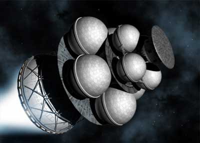

It sounds suspiciously like the inertial confinement fusion system used in the "Daedalus" interstellar probe designed by the British Interplanetary Society. See e.g.:
http://www.daviddarling.info/encyclopedia/D/Daedalus.html
or
http://www.bisbos.com/rocketscience/spacecraft/daedalus/daedalus.html
Daedalus used electron beams rather than lasers, though.
Regards & all,
Thomas L. Nielsen
Luxembourg
