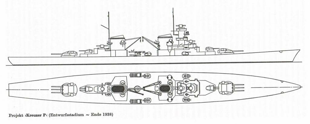

I'm looking for a better resolution version of this drawing of Kreuzer-P.
The biggest problem with this one is that you can't read the text.

I researched and poked around and unfortunately I cannot find anything with exception to this image, which is very similar to what you posted.
It's approximately similar.

Well, this is the well known A-V drawing. I believe this one is from Breyer's "Schlachtschiffe und Schlachtkreuzer 1921-1997", pg 185. There is a similar one in Gröner's "German Warships 1815-1945 Volume One: Major Surface Vessels".

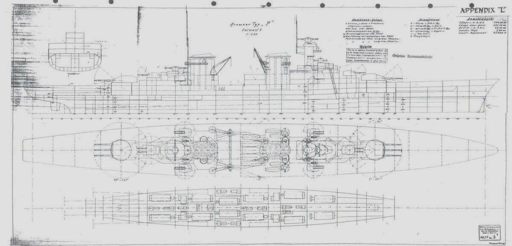

The drawing in Appendix F that I provided earlier is compelling because it is similar to the one in Breyer's "Battleships and Battlecruisers 1905-1970" (yes, that's the English translation) pg 305. Breyer says it is from late 1938.
The Appendix F version is much more detailed, and has some interesting differences. Breyer pretty admitted that his drawing was mostly from memory. Since the Appendix F version seems to be original, it is, to my mind, much more valuable. Unfortunately, the resolution of the image is not good enough for us to read the text.

You mean Appendix L? its probably lost somewhere in the bunderarchiv, in the list of nameless scans and documents, i see what i can find on German and Russian forum sites.
Appendix L - P cruiser
Appendix M -???
Appendix N - KW45/50 battlecruiser.

Sorry, you are correct, Appendix L. I'd blame a "fat finger" error, but the keys are too far apart. :)

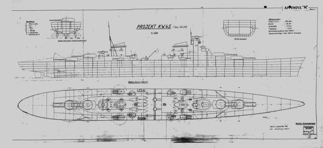

I have some some plans for KW45/50 and some data. A lot of info is currently unknown or is generally unknown due to it being a private design that was drawn up by the Kriegsmarinewerft. The KW in the design name is short for "Kriegsmarinewerft".
In 1939, 2 versions of this project were submitted for consideration by the Kriegsmarine shipbuilding commission ( German: Neubauausschuss ): KW45 and KW50 .
They slightly differed from each other in displacement , armor, and also in size. Armament and layout were identical.

Note: The two KW designs looked nearly exactly the same. However, if you look at the top left on the blueprints, you can see a version with 3 propeller, and a slightly visible version with 4. I think KW50 had 4 propellers, since it was the largest of the two. If I am mistaken I will correct it.
Or if it was just a proposed planned selection of areas propellers could have gone I will correct this if someone points it out.
