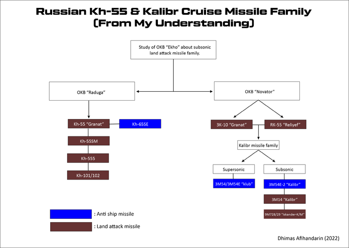

I tried to make a pedigree for Kalibr missile family. Umm this one does not include the 91RE1 and E2 variant which serves entirely different mission. and not meant to be chronological. But it shows the origin and how the development were split between Raduga and Novator.

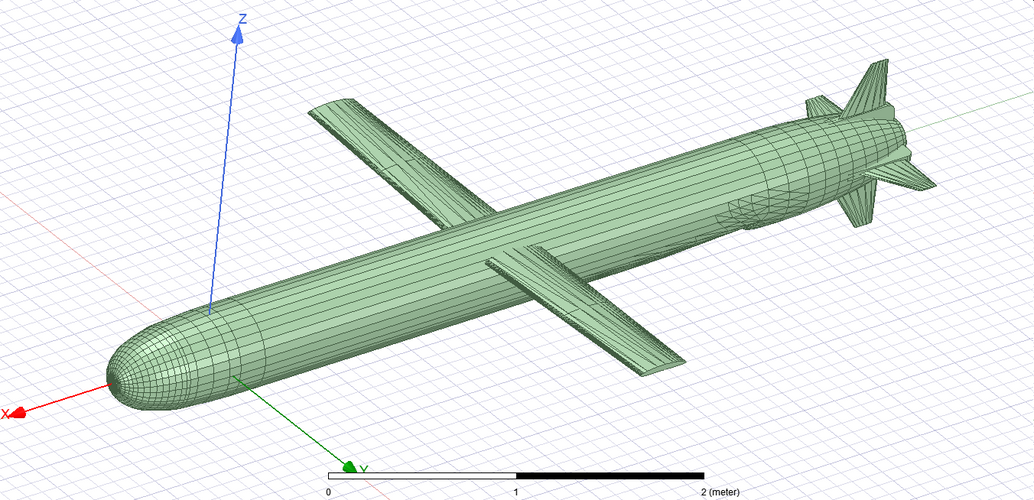

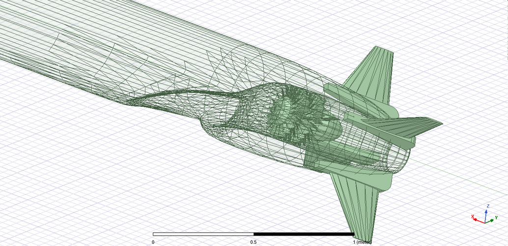

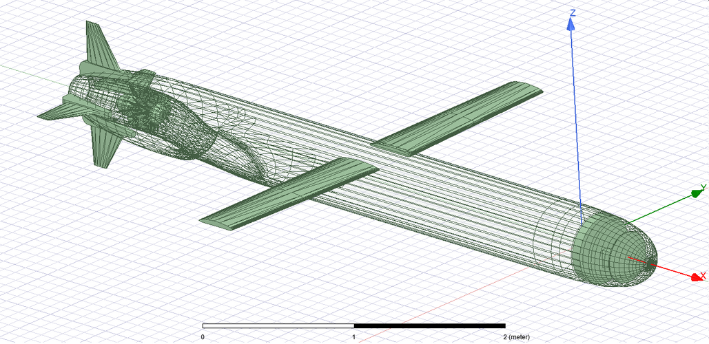

A kind of quick estimate on Kalibr frontal RCS. 35 frequencies are assumed. Limited to frontal aspect. think it's enough.
2 Kinds of Kalibr models are assumed. One with fully RF transparent radome with Ceramic-composite (basically pyroceram) while another is a full PEC to assume bandpass radome which are opaque.
The model on left have the conventional radome, while on the right is one with bandpass. Inlet is also modeled as well as simple flat plate seeker antenna for the version with conventional RF transparent radome.
With a "mock" jet engine fan. The interaction of the model with radar frequencies can be viewed here :
Bandpass Radome :
View: https://twitter.com/Flankerchan/status/1569409776987275264
Conventional RF transparent :
View: https://twitter.com/Flankerchan/status/1569409812395626496

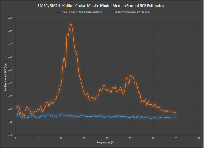

The medianized result :
The version with Bandpass radome or well probably a pure land attack version without radar seeker perfectly maintained about 0.13-0.14 sqm. While one with conventional RF transparent radome have rather large increase in X-band region. The reduction of the median RCS for higher frequency is related to the radome material i simulated and overall, simplicity of the seeker antenna being modeled.

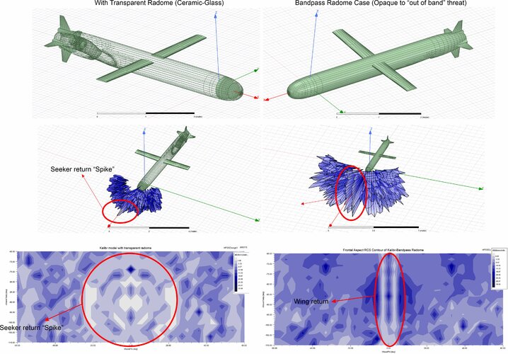

On the subject on how the model behave, as can be seen taken for frequency of 10 GHz. for the model with transparent RF have relatively dominant return from seeker sidelobes and mainlobes. While one with bandpass return from the almost nonswept and small taper ratio wing showed up more clearly than the return from fuselage.
I'm curious if wing leading edge treatment can reduce it in the manner that make it almost "buried" with other part's RCS. The return from the Jet engine is unfortunately not very visible due to the limited aspect being modeled. I'm not sure however if it will even visible in typical engagement unless the missile somewhat already very close or sufficiently high.

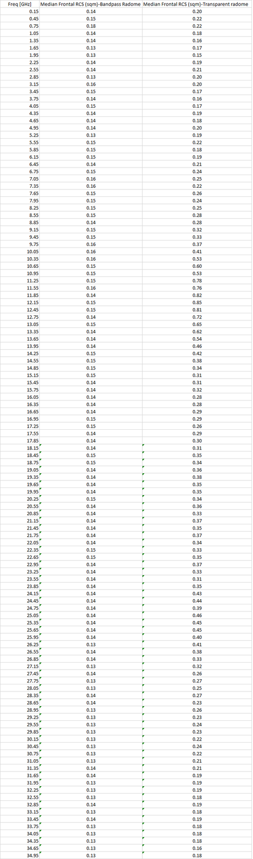

Here i also included the RCS vs Frequency table for maybe if anyone interested in actually tries to calculate radar range.
