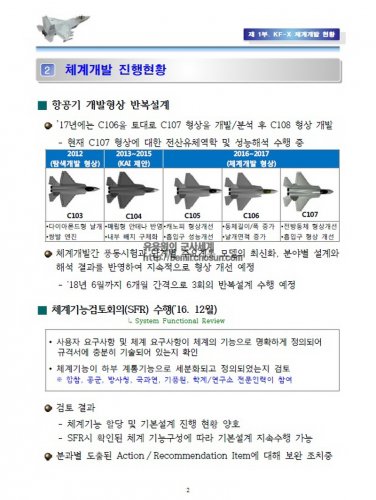

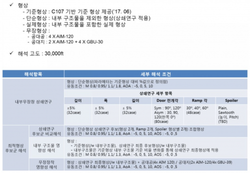

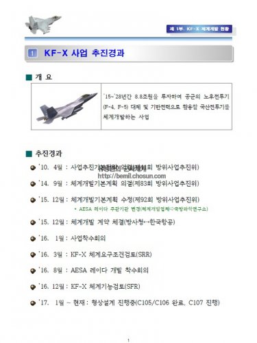

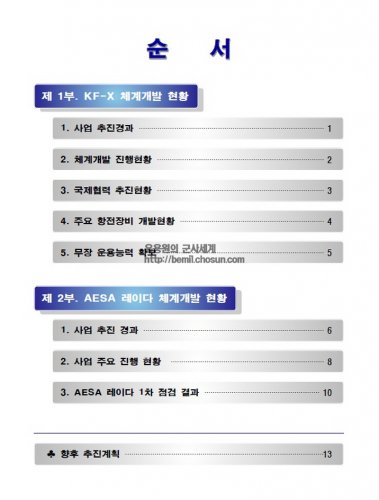

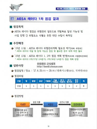

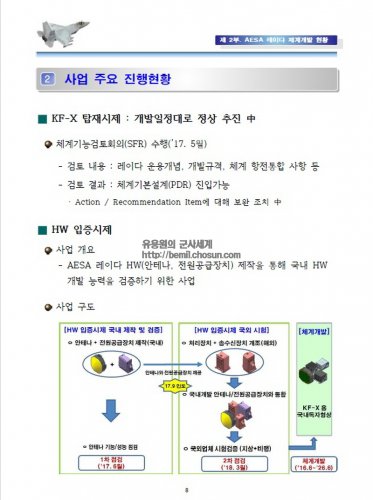

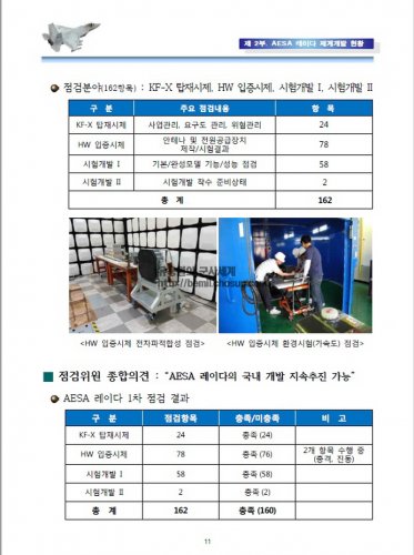

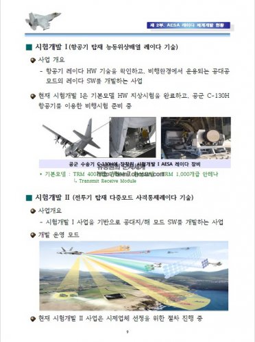

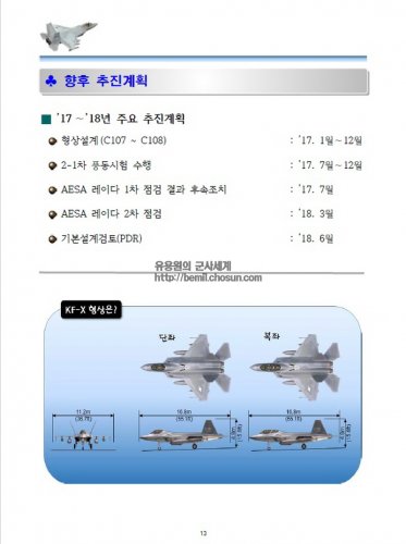

The latest iteration of the KF-X is the C107 design which has lots of little aerodynamic improvements and has gone to F-22 style vertical tails over the previous F-35 style ones. (The nose IRST is also a big change)
Further images @ this blog:
  • http://blog.naver.com/jhst3103/221026547190
  • http://blog.naver.com/jhst3103/221026834942

Good overview and news on KFX.
http://aviationweek.com/defense/south-koreas-kf-x-grows-considerably-development
Latest iteration ... maybe !?

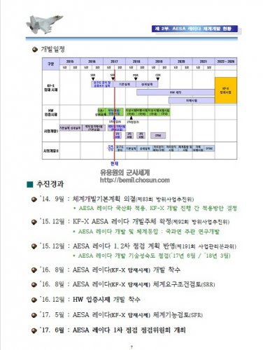

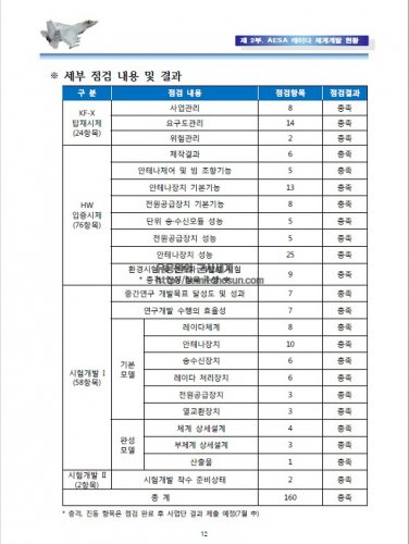

AESA Radar development seems to be moving along
http://english.yonhapnews.co.kr/search1/2603000000.html?cid=AEN20180531002900315

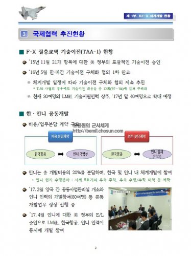

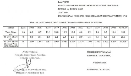

Indonesian shares on KFX. Excerpted from MoD regulations on KF/IF-X development. parts written in Indonesian are not important.
Problem from Indonesian side is related to attitude in our govt as some consider the project is fruitless while we need to keep paying. ON the academic side, we wish for more control which kinda absurd. However it difficult to exit anyway as we already poured funds into manufacturing facility for the fighter. We also already purchased some manufacturing equipment like autoclave and others. The facility is ready and some part already used to help develop our local N-219 light aircraft. There is also concern related to the number we would acquire that some consider 40-50 aircrafts just won't make break even points.

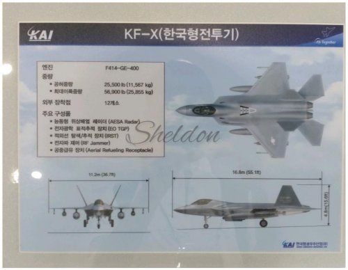

Design of the KFX :
https://www.defensenews.com/air/2018/06/29/south-korea-unveils-first-images-of-kf-x-design-with-european-missiles/
