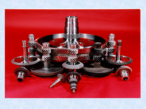

Looking at the Comanche's transmission, I usually find myself asking myself whether an "anti-torque" system is needed per se. The Comanche is interesting in that it employs a split-torque gearbox without a final planetary reduction stage, as pictured below.Another view of "CHITA". I'm not sure how the antitorque works on this.
Correct me if I'm mistaken, but without a fixed ring gear to transmit reactive torque from the main rotor into the fuselage, the tail rotor/fan mainly serves to provide yaw control as opposed to yaw stability...
You can't drive a rotor shaft without receiving a corresponding counter torque. That's against physics.
