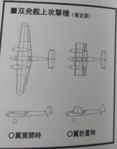

What is this plane? It is from a picture in the thread below about successors to the Tahio class carriers.

The drawing which shows twin engine carrier bomber is a estimated drawing (推定図). But the project seemes to be a real.
According to this document, the specification of this aircraft was decided by Dr.Masao Yamana(Kugisho, Suisei designer).
Weight : 8ton, Length : 12.3m, Span : 18m(9m), Height : 3.5m
Maximum speed : 250kt(463km/h)/4000m, Range : 900nm(1666km)(attack),1700nm(3148km)(reconnaissance)
Torpedo : 800kg or Bomb : 1000kg
Engine : same as Suisei?(seems to be liquid cooling engine)

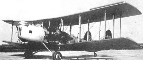

This the navy type 93 attack bomber(Mitsubishi 3MT5A~3MT5) was initiallly designed as 7-shi twin engine carrier attack bomber to carry large torpedo in 1929.
But judged as not suitable for carrier use.
The twin engine carrier bomber(unified attack aircraft and dive bomber) discussed here was planned in 1940.
When planning a high-performance dive bomber more than 13-shi dive bomber Suisei, there was a limit in the single-engine aircraft.
Then twin-engine attack aircraft/dive bomber and large aircraft carrier were planned.
But Nakajima succeeded to develop high performance Homare engine, neccesity of twin engine carrier bomber disappeared.
