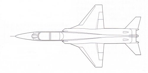

Hi! Fuji, Kawasaki and Nihon hikoki's joint proposal for Japanese T-2 supersonic trainer project(T-X).
Basically this plan was designed by Fuji Heavy Industries. Fuji approached Northrop to ask T-X design assistance or T-38 licence production at the day.
This drawing is not a original one. This is a reconstruction drawing based on designer's memory. I hope we find original drawing near future.
That's new for me my dear Blackkite,thank you for sharing us.

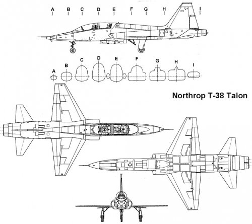

Not at all my dear hesham. It looks like Northrop T-38. Unfortunately I can't find front view and side view. Perhaps these were T-38 like shape.
