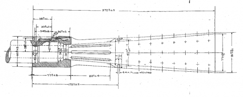

Here you've got an excerpt from a report of US Navy Technical Mission to Japan on the Type 5 40mm gun as well as a drawing of the 25mm gun Rheinmetal-type flash hider.
Another USNTMJ's report on muzzle brakes and flash hiders includes the following paragraph on the Type 5's flash hider:
The 40mm Bofors guns, which the Japanase had captured in Singapore, were equipped with the simple cone. Although the 40mm gun was never in service for the Japanese, sufficient test had been conducted to indicate that the simple cone type flash hider was unsatisfactory. Guided by the results obtained in case of the 25mm gun, the Navy next tried the Rheinmetal designed for the 40mm. The results were unsatisfactory, and the decision was made that a different type be designed. The end of the war precluded any work at all on the new design.
Piotr
